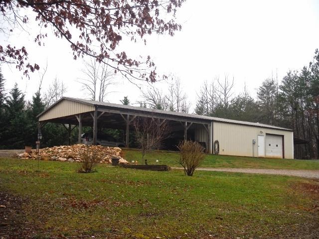

Cool, Joe! I have a nice place to park your rides. Got a 30x80 slab. The first 30x40 is carport. Then the 30x40 garage starts from there. -
