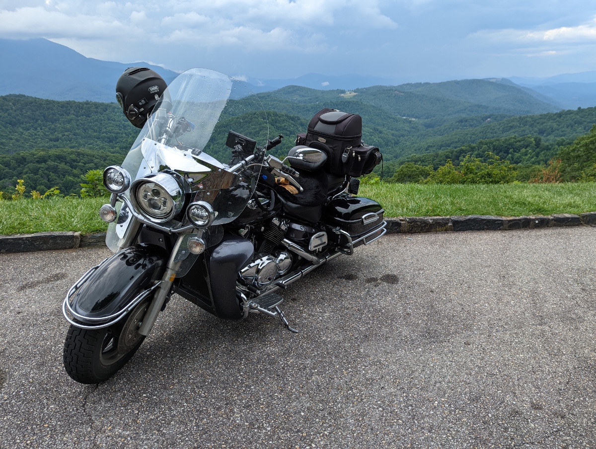

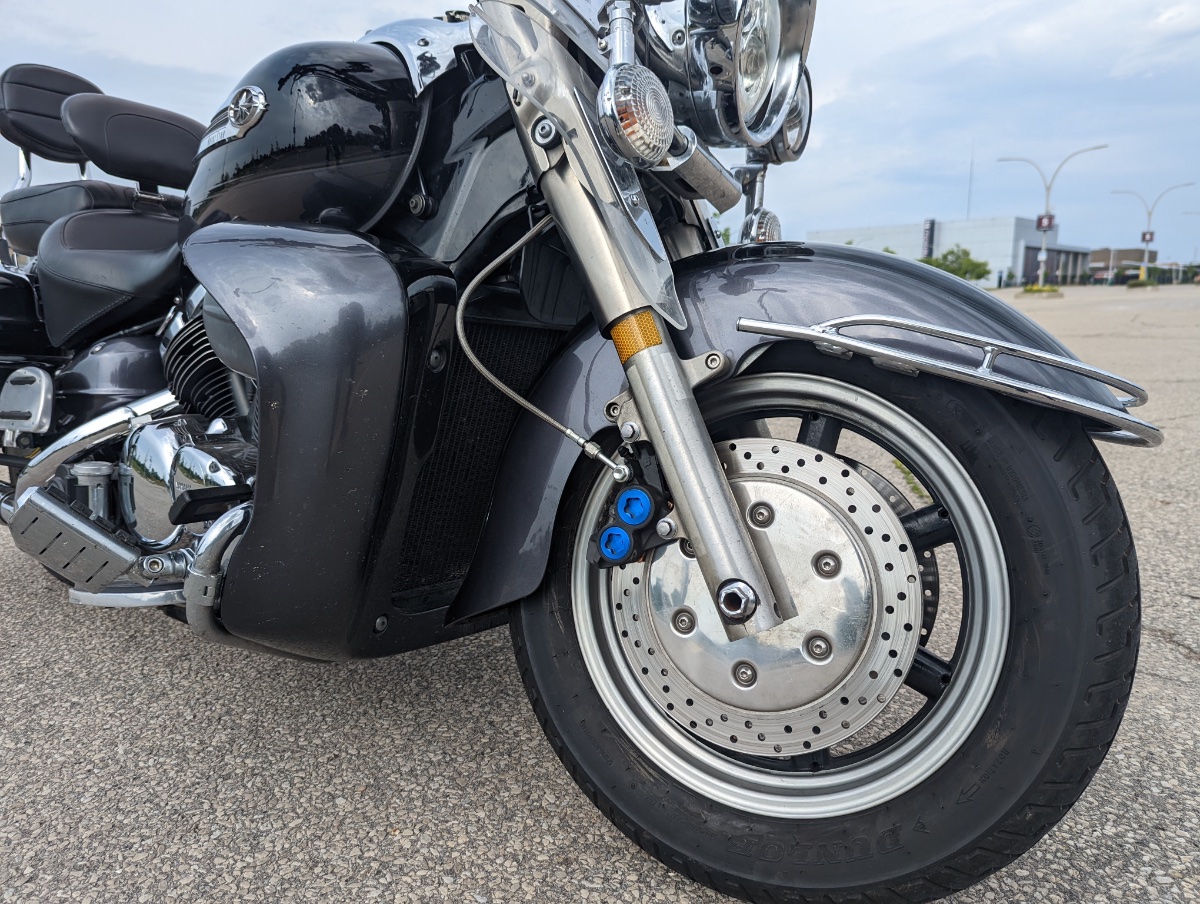

Papabird Posted August 17, 2022 Posted August 17, 2022 (edited) I was finally able to get my new (to me) brake calipers installed onto my 2005 RSTD. Same works on 99-13 RSV. @skydoc_17 (Earl) sourced the calipers, stainless steel brake line and appropriate banjo bolts for the conversion. Earl was excellent to deal with as well. The install was straight forward and worked great. I picked up new EBC sintered brake pads for the new parts. My donor bike was a Yamaha R6 that was hit in the rear end. Fresh DOT4 fluid was installed at the same time. The improved stopping power is noticeably immediately. My Blue Ridge Parkway trip last month was the real test and I was hugely impressed and very confident with my new stopping power. This is a highly recommended upgrade for your RSTD or RSV. Edited November 1, 2022 by Papabird spelling 1
skydoc_17 Posted October 9, 2022 Posted October 9, 2022 Thank you very much for the kind words! All I did was supply a few parts, YOU did all of the work yourself, and frankly I am VERY impressed with how good a job you did! Not to mention those calipers look GREAT on the front of your bike! Safe Journey's my friend! Earl 1
