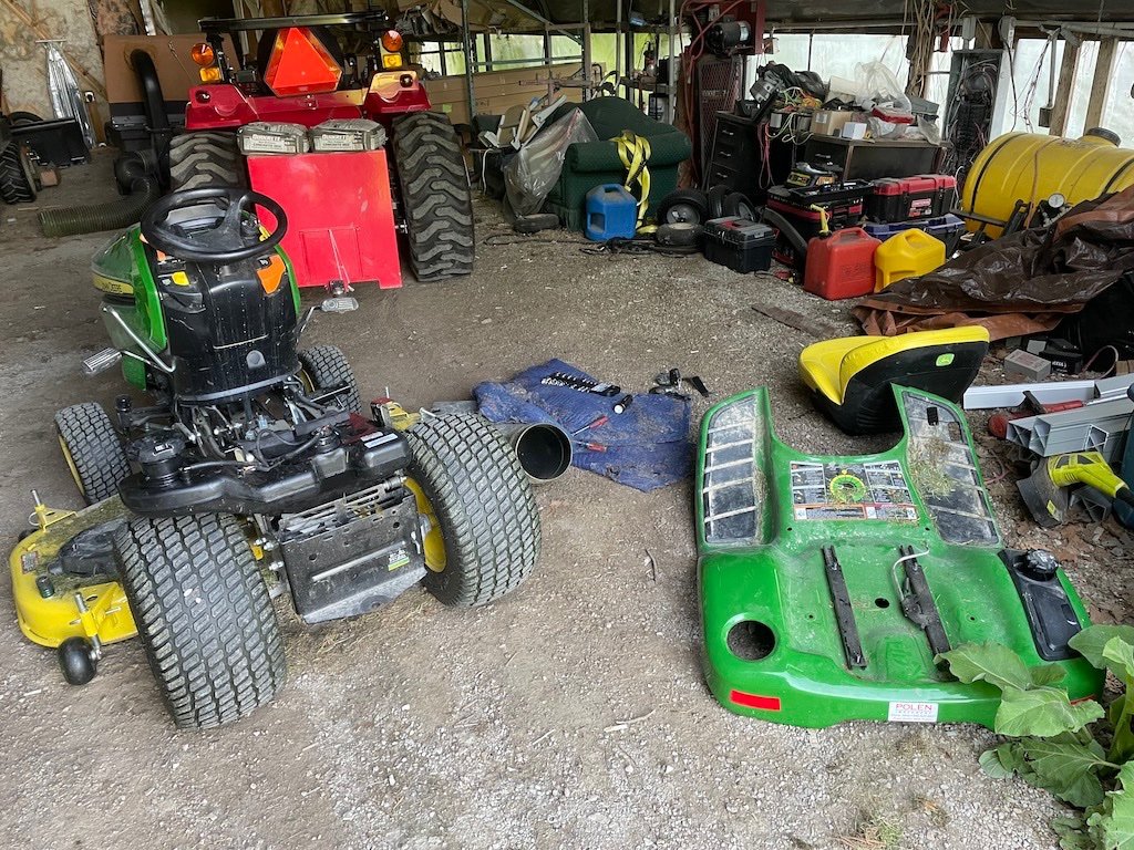

Freebird Posted May 25, 2022 Author Posted May 25, 2022 Well, there was just no easy way to do it. There is a "shelf" sort of thing about 1/4 - 1/2 inch down inside the fill spout. No way to get anything in the tank to suction it out. So the bad news is that I had to take it apart to remove the tank. I think I got all the grass out of it. Then rinsed it very well with water and then put about a half gallon of gas in it and sloshed it around really good to get as much of the water out that could. Then put it all back together. The good news is that it wasn't nearly as bad as I had imagined. I still need to pick up a new filter tomorrow. Now I just need to clean this thing up. It's really nasty.
