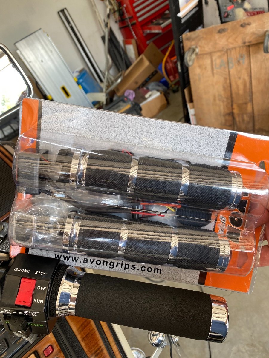

Pasta Burner Posted September 6, 2021 Author Posted September 6, 2021 These just showed up. I think they’ll look nice and the heat is just a bonus if they work. For $65 it’s worth a shot. 1

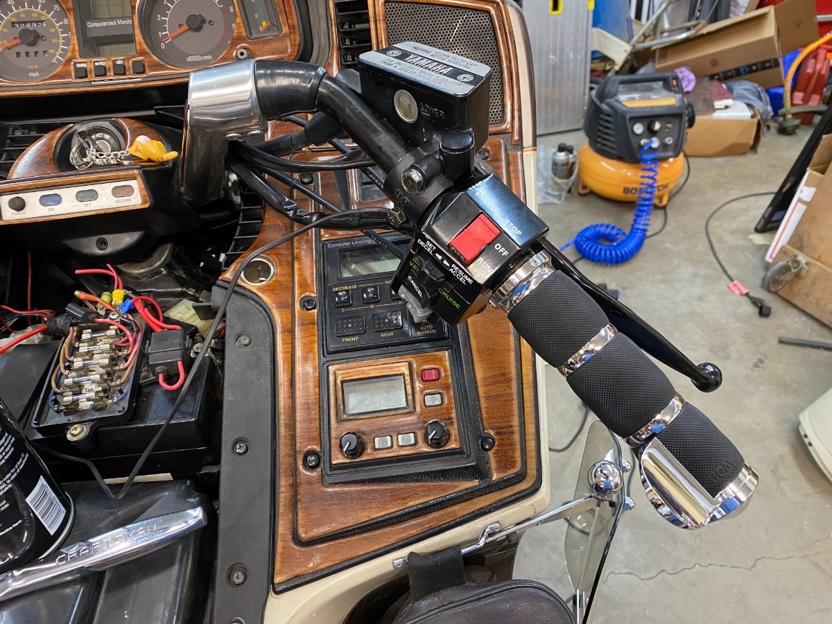

Pasta Burner Posted September 9, 2021 Author Posted September 9, 2021 Throttle grip installed just so y’all can see what it looks like. Haven’t decided which side I’m going to mount the control yet. 1

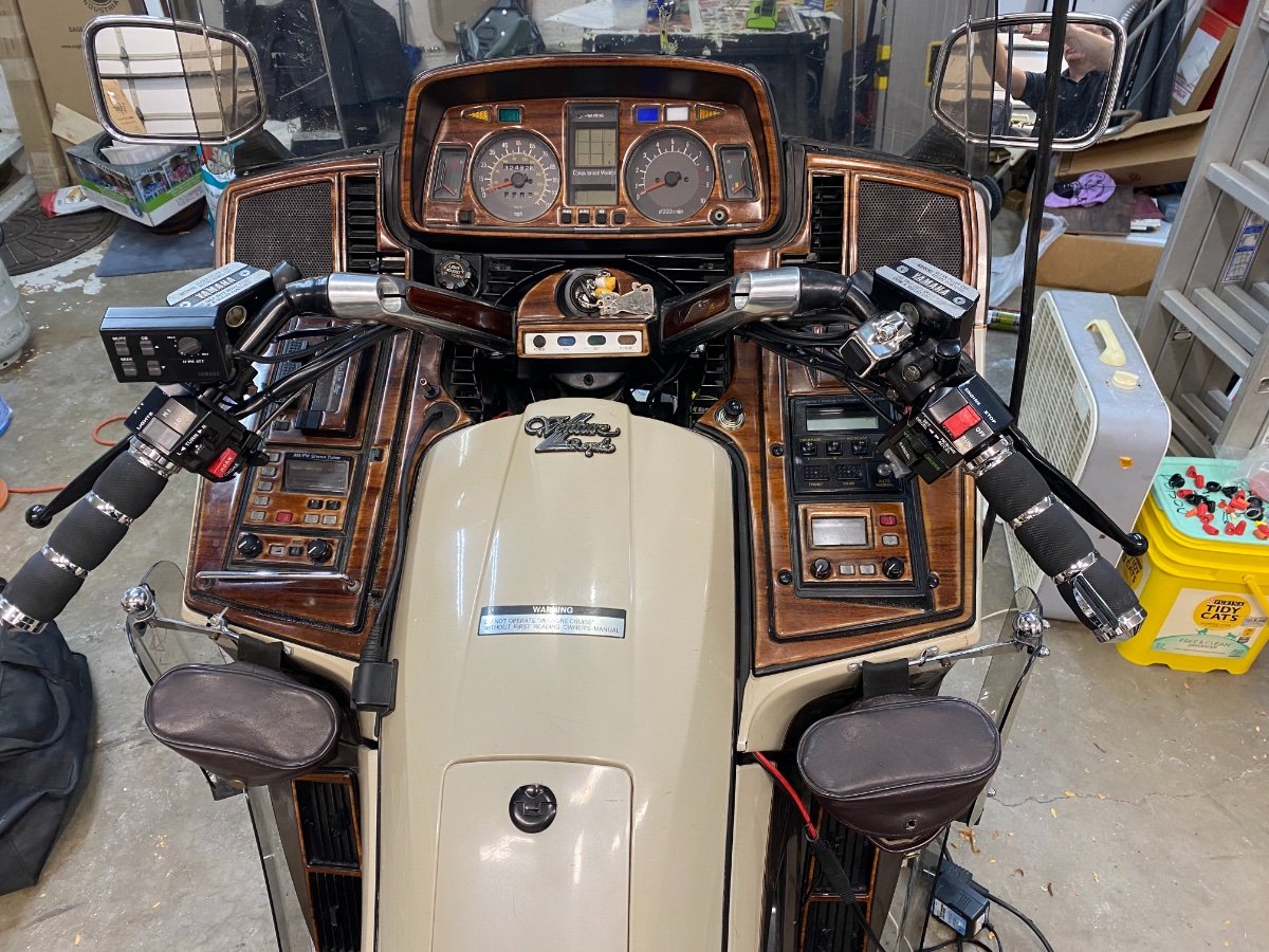

Pasta Burner Posted September 20, 2021 Author Posted September 20, 2021 Finally finished🤞 After receiving the replacement module and installing per the directions the same thing happened. I did a little more testing on my end figuring I’ll just make my own module if needed I discovered mating black to red from the module to the grips provided the correct wiring. (The new module also puts out almost double the voltage which is something the engineer mentioned when I spoke with him last week. Something about an updated one which I suppose addresses the lack of heat issue I mentioned in my initial post.). Test ride yet to come, but in the garage they feel nice. 1
