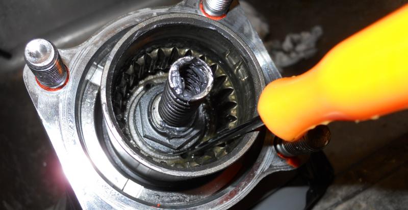

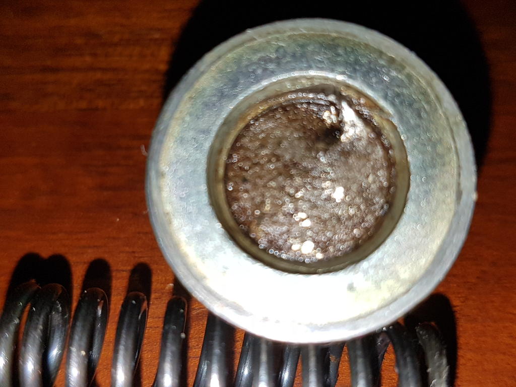

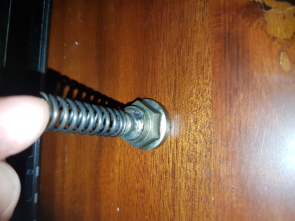

Patch Posted June 9, 2018 Author Posted June 9, 2018 So received a very nice condition final drive this evening. Prepping it for the shaft look what I found on the old unit. If you have on these before you'll know by the spring where it goes.

videoarizona Posted June 10, 2018 Posted June 10, 2018 So received a very nice condition final drive this evening. Prepping it for the shaft look what I found on the old unit. If you have on these before you'll know by the spring where it goes. That looks like a broken bolt to me....I had one like it on my 1st Gen...
Patch Posted June 11, 2018 Author Posted June 11, 2018 Yep it is the top of the pinion gear. That nut hold the pinion to the coupling gear keeping both in place.
