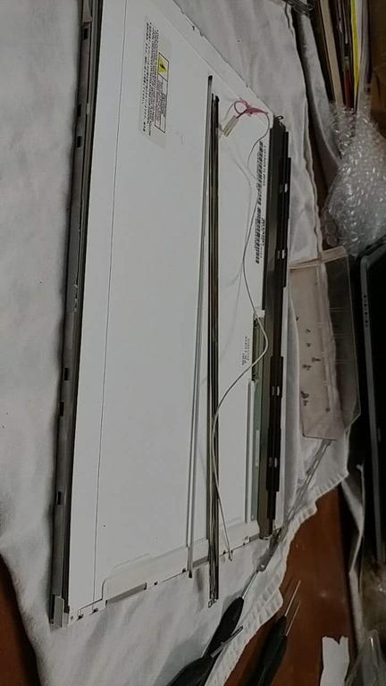

rbig1 Posted March 12, 2018 Posted March 12, 2018 well bought a new video driver. I was just going to throw parts at it. Got to watching the good old youtu saw some vids on replacing back light. so I took it apart one more time. The one side of bulb was separated from wire and ends were black. Well already spent 20.68 on driver whats 7 bucks more. Just about way to blind to see those miniature screw heads. But I got it apart. Any of ya change one of these ccfl bulbs.

rbig1 Posted March 13, 2018 Author Posted March 13, 2018 Well the end of the bulb rotted off along with the wire. I think it may have leaked the mercury out of the bulb toward the end of its life and finished killing the wire. I broke the other end off when trying to get it off as it was stuck real good and just as black. Had to order one with the wire installed as even the rubber caps were toast. Should be a challenge to put back together with out breaking it. Shaky hands don't help with this. Don't think the screws could get smaller. Think I,ll try to find a set of those glasses. I also think this is a one time deal wont do another one unless I have another weak moment.

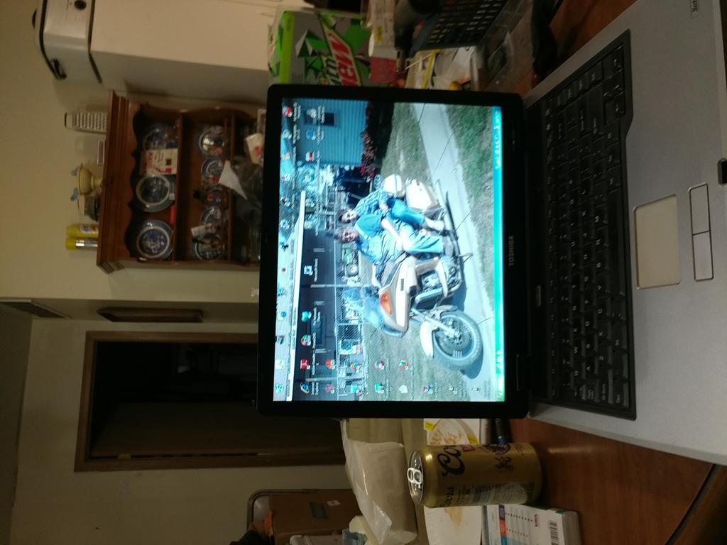

rbig1 Posted March 16, 2018 Author Posted March 16, 2018 I'm writing this on the old xp. D.on't think I want to do that bulb again. Its still updating right now. Was surprised it hooked up to new wireless. The anti virus expired in 2012. lol Will post pic of screen when i get phone up to date.
