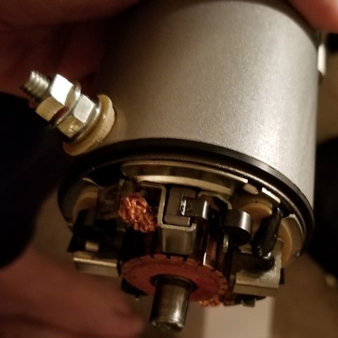

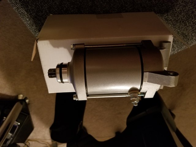

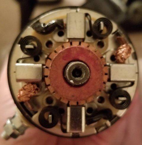

ken5124 Posted January 19, 2018 Author Share #9 Posted January 19, 2018 New starter arrived today.. Took Some pictures.. to confirm this IS a 4 brush starter Part number SMU0366 Got it from the link listed at the beginning of the thread. Now to wait for winter to be over. HAHA. Link to comment Share on other sites More sharing options...
Marcarl Posted January 19, 2018 Share #10 Posted January 19, 2018 I think you got had!!! That to me looks like a 2 + 2 brush starter,, wait now,,, 2+2=4,,,,, guess you're ok. Link to comment Share on other sites More sharing options...
