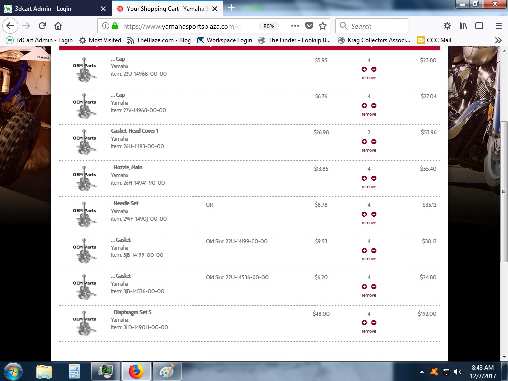

luvmy40 Posted December 7, 2017 Posted December 7, 2017 (edited) I'm planning to rebuild my carbs this winter. YamahaSportsPlaza.com has the best price I found for the head cover gaskets and, so far the best prices on the carb parts that I can find. Does anyone have a better/cheaper source? Here's a screen shot of the carb parts in a shopping cart: The diaphragm, set 5 is the coast circuit diaphragm, not the main piston diaphragm. Edited December 7, 2017 by luvmy40

luvmy40 Posted December 7, 2017 Author Posted December 7, 2017 Partzilla is a few dollars cheaper across the board and free shipping on orders over $149.00. Only problem is they don't have the main nozzle or needle assy. in stock, so that kind blows the free shipping if I have to order them from YSP.
luvmy40 Posted December 7, 2017 Author Posted December 7, 2017 I went ahead and ordered the parts that I absolutely know need to be replaced, including the head cover gaskets from HELL(well, from china actually) from Partzilla. Hopefully the main nozzles, needles and coast diaphragms don't need replaced. I have already inspected the main slide diaphragms and they are fine so I'm keeping my fingers crossed. For the carbs, I ordered the rubber blocks for the jet blocks, the jet block gaskets and the choke block/enricher block gaskets. I have half a dozen different o-ring kits so the o-rings should be covered.

luvmy40 Posted December 8, 2017 Author Posted December 8, 2017 (edited) cimmer, Thanks! Parts Shark appears to be just a bit cheaper than Partzilla though I didn't dig in far enough to see what shipping costs are there. Yamahasportsplaza.com does have the main needle assy. and main nozzle available. They're pricey, though cheaper than the local dealership. ETA: The needle set I found is for the '89 V-Max 1200 not the MK1 Venture, sorry! I may order one just to compare them. Edited December 8, 2017 by luvmy40
