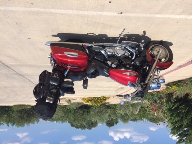

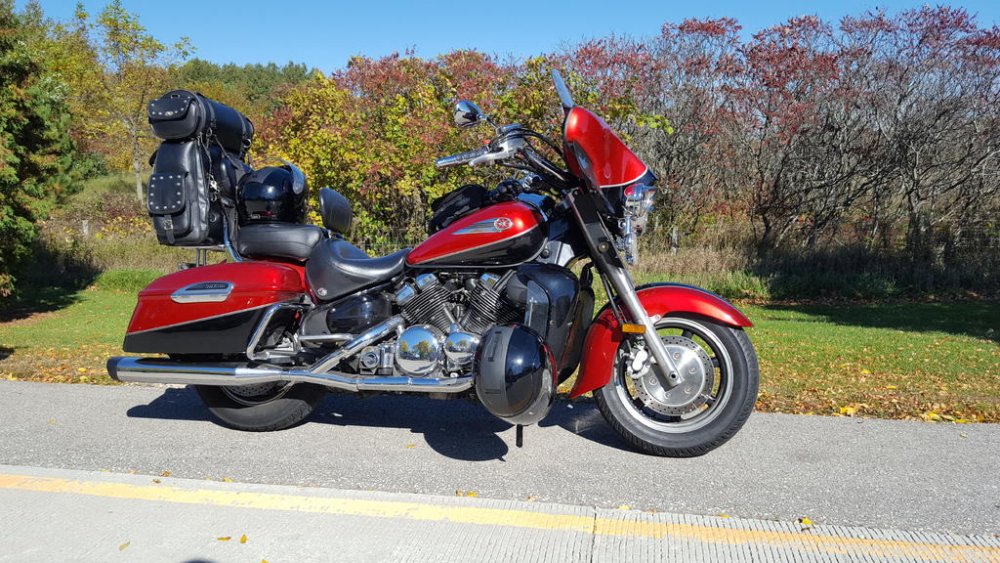

BigLenny Posted October 13, 2016 Posted October 13, 2016 Yea I understand but this is how we rode this weekend, 950 miles 2 up fully loaded, During this trip I changed the shock many times from 0 on up to 35 and saw no difference in the harshness of the ride. http://www.venturerider.org/forum/attachment.php?attachmentid=107612 Know what you mean Darrin by loading it up and riding 2 up. Its a lotta weight.
DarrinGT Posted October 13, 2016 Author Posted October 13, 2016 LOL, Looks like a Mirror Image!! That's the way to travel! Looks good Lenny!

BigLenny Posted October 13, 2016 Posted October 13, 2016 LOL, Looks like a Mirror Image!! That's the way to travel! Looks good Lenny! Thanks! But that dang faring on yours makes me jealous. LOL.
