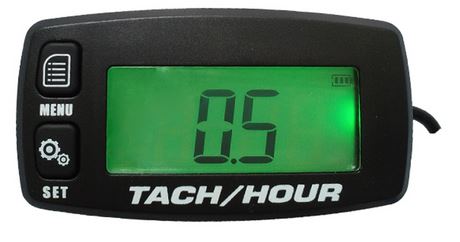

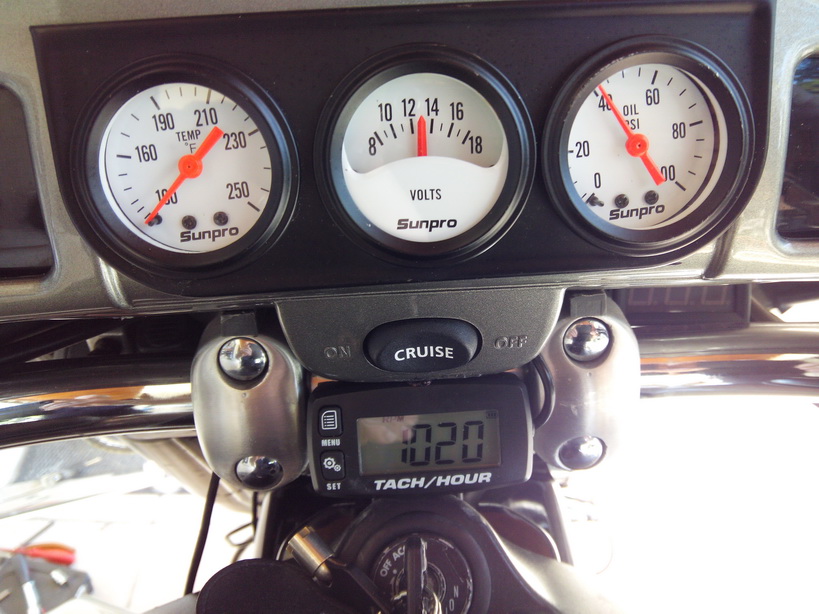

ChrisFrench Posted June 9, 2016 Posted June 9, 2016 Here's what I found: A standalone tachometer and without electricity and with an accuracy of 10 revolutions / minute for 20 dollars. Just wrap the wire on the plug wire of 4 laps http://fr.aliexpress.com/item/Free-Shipping-Digital-Resettable-Inductive-Tacho-Hour-Meter-Tachometer-For-Motorcycle-Marine-Boat-ATV-Snowmobile-Generator/32231643007.html
gibvel Posted June 10, 2016 Posted June 10, 2016 Very interesting ChrisFrench. What setting do you use to make it work with our engines? Wish I could find somewhere to get it from the US.
ChrisFrench Posted June 10, 2016 Posted June 10, 2016 Hello, Bought on aliexpress.com Fits any type of engine, from 1 to 8 cyl. RPM automatically operates when the engine is running. No electrical connection. http://www.aliexpress.com/item/Free-Shipping-Digital-Resettable-Inductive-Tacho-Hour-Meter-Tachometer-For-Motorcycle-Marine-Boat-ATV-Snowmobile-Generator/32231643007.html?spm=2114.30010308.0.311.iy2Wmh
k9cottage Posted June 11, 2016 Posted June 11, 2016 i just got this on ebay in tassie should be here monday seems to have lots of settings for different sorts of motors http://www.ebay.com.au/itm/BLUE-hour-meter-tachometer-maintenance-timer-yz-yzf-wr-xt-125-250-450-Yamaha/152010357877?_trksid=p2047675.c100005.m1851&_trkparms=aid%3D222007%26algo%3DSIC.MBE%26ao%3D1%26asc%3D20140106155344%26meid%3D31d40d6961f74c1dbdd7c7fc54e654af%26pid%3D100005%26rk%3D2%26rkt%3D3%26sd%3D161894488517
