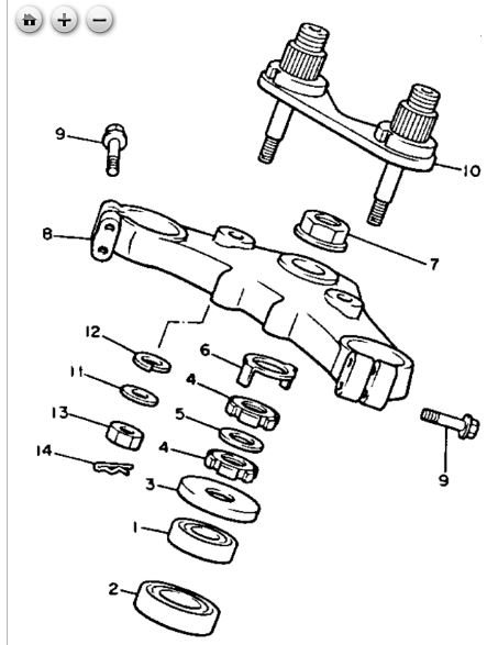

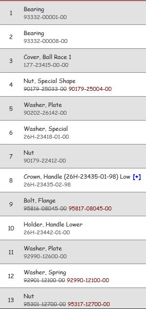

Wilzhere Posted May 18, 2016 Posted May 18, 2016 (edited) Well it is to late now. The front of the bike is scattered all over my shed. As soon as all the new parts are here I get to see if i still remember how to put it all together again. I do intend to do a "How To" writeup on the steering bearings. Just got done doing mine from the bottom up. i did my forks also so i did remove my front fender after i removed the forks as a unit, i use a long pointed punch to remove the races in the neck,,,did the dremmel tool with cutoff blade for bottom bearing removal now im asssuming you have done the same so ill jump to a pic of steering head assembly #nut (7) is torqued to 80 lbs this is a really important watch this video for bearing adjustment hxxps://youtu.be/CvtI4wEUCwE change xx 2 tt ...the first of the vid is boring but the way to make sure your steering is not to tight is dead on important, mine were to tight at first so i know i got plenty of preload on the bearings, then i backed off till i could get it like the vid, its just great now. As far as bearings go make sure you pack them right your self. i just use the palm of my hand with grease , just keep pushing grease through it till it shows through smaller taper of bearing, grease the race also, these head bearings dont come packed with grease at all. many time peeps i know and have redone head bearings is lack of packing grease and overtightning hope this helps Edited May 18, 2016 by Wilzhere

Flyinfool Posted May 18, 2016 Author Posted May 18, 2016 Thanks Will That #7 nut that is supposed to be torqued to 80 lb/ft, I removed with no tools, it was about a half turn LOOSER than finger tight. I made my self a tool to push in the races. Your link did not work, but I found the vid I never learned any way other than to get my hands dirty to pack a bearing. Even my 3 daughters learned how to pack a wheel bearing when they were teens. That was my "payment" for helping them do front brakes on their cars. The look on their faces was priceless the first time they had to stick their hand in the tub of grease.
