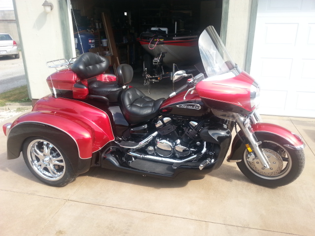

I got a Clarion 6 Disc changer with the Hannigan but it wasn't installed. I was told that the wires were tucked in under the trike kit bit I haven't looked yet. The question I have is "how is the unit controlled ? " I have a changer - period. I'm sure there has to be something to tell it to play etc. It surely doesn't integrate into the bikes audio system like the radio controls ?
If the cd changer came on the bike as my 09 was then it is controlled through the radio pod on the left handlebar. If it isn't hooked up, then it will not show it in the control pod. I took mine off several years ago, so I'm not sure if it will even show up without a disc in the drive. Anyway, it(the changer) should be connected by a large round cable(C-bus) that runs forward to the front fairing and is connected to the audio harness up there.
Yes, if it has the proper cables, it does integrate into the bikes control pod. Once it is hooked up and plugged in, it will show up on the pod.
LOL...I see that Kirby beat me with the answer. Not only did he beat me but his was better too. :)
On another note, unless someone has removed it from the bike since it was new the wiring should already be on the bike. It originally was routed into the left saddlebag from the backside. The 09's came standard with the cd changer, or at least mine did.

Thanks for the info - it makes a lot more sense now. The po said that I would have to drill a hole for the cable. I guess I need to decide where to mount it, or rather where the cable will allow me to mount it
I mounted mine in the trunk of my 07, as I recall there was a rubber plug on the right side floor that you could slit to bring the cable thru.
The factory mounting system is what really takes up the space, I did not get that on the free one I received from anoter member here, so I stood it on it's side and removed the cargo net on the front bulkhead of the trunk. I fashioned some aluminum straps and foam packing material to create a cradle to hold it up against the front bulkhead. I then installed the cargo net back in place using tiewraps to allow it to "stretch" around the CD player. You do have the change a couple of screws or some thing on the unit to allow it to work properly on its side, but it is easy and if you look a the case there are instructions or arrows pointed to the positions of the screws verse mounting position. I think I have photos still on another computer or disk, if you are interested, PM me with an email address and I will see if I can find them.
Thanks Steve - I'll probably mount it flat as I already have the wrap around metal mounting bracket. If the cable is long enough I'll also put it in the tour box just for easy access. I'm dealing with a Hannigan trike kit so I don't know for sure where it will go -
