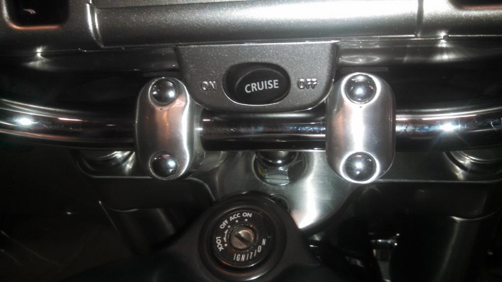

MikeWa Posted August 1, 2015 Share #4 Posted August 1, 2015 Don't know what to tell you. I have the riser extensions on my bike but I was able to squeeze the dampers in. It was tight but doable. See pic. Mike Click to view Link to comment Share on other sites More sharing options...

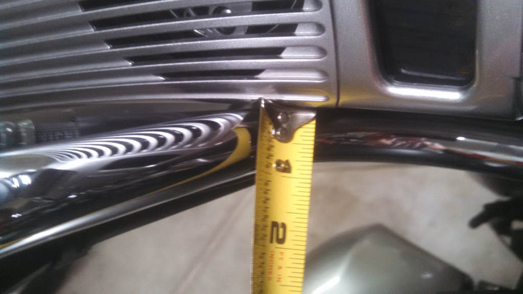

videoarizona Posted August 1, 2015 Author Share #5 Posted August 1, 2015 (edited) Thanks for the pic, Mike. Looks like you have more room than I do??!! I just measured. I have a tad more than a 1/2 inch between the bars and the inner fairing.... Hmm...I haven't done anything to inner fairing so guess this must be from previous owners as well.... Interesting. Anyone else have Baron riser's and have the dampers installed like Mike does? Edited August 1, 2015 by videoarizona Link to comment Share on other sites More sharing options...

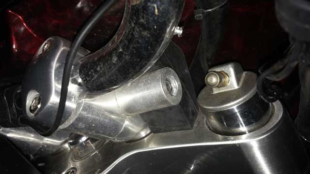

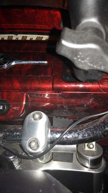

djh3 Posted August 1, 2015 Share #8 Posted August 1, 2015 I dont remember the manufacture of my risers, but I would think they are all made very similar. It almost looks like your fairing has tilted back. Maybe because of no support. There is an inner mount bracket, maybe split the fairing and make sure all the bolts are on that thing. Other option is maybe go to local hardware store and find something hard rubber. I know Lowes has some rubber stoppers you could measure the gap and cut the stopped and a piece of double stick tape it to fairing. It cant be particularly good for the fairing to be bouncing with no support. I will take a couple pics of mine later. Link to comment Share on other sites More sharing options...

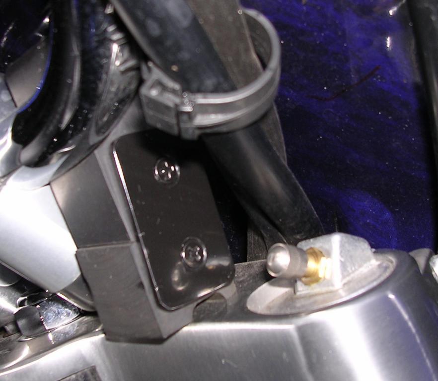

M61A1MECH Posted August 1, 2015 Share #9 Posted August 1, 2015 When I put risers on my 07 , I went to the auto parts store and got a pack of those hard rubber spacers people put in between the coils of springs in the suspension to get a little bit of lift. The rubber is really hard, I shapped them using a disc sander fitted to my wood lathe, took a bit of fiddling around, I think I used the original dampers for the top because it was shaped to fit the handle bars and then attached the ones I made to them with an aluminum piece I painted black. Link to comment Share on other sites More sharing options...

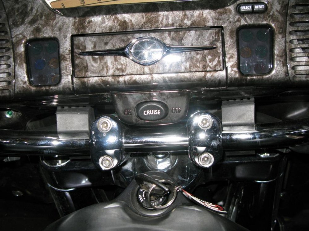

djh3 Posted August 2, 2015 Share #12 Posted August 2, 2015 Here some pics of mine. Link to comment Share on other sites More sharing options...
videoarizona Posted August 5, 2015 Author Share #13 Posted August 5, 2015 Dion, yep..you have more room than I do. Right now, I'm waiting for two things to get shipped in, when they are installed...I'll take apart the fairing and look at the mount for something different. To many parts sitting on the bench/garage floor at this point. Don't want more. I didn't put the Baron's riser on so who know what else has been done to the scoot? Link to comment Share on other sites More sharing options...

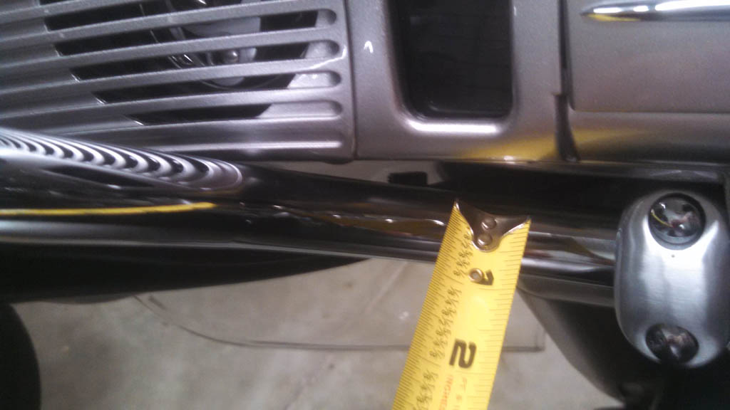

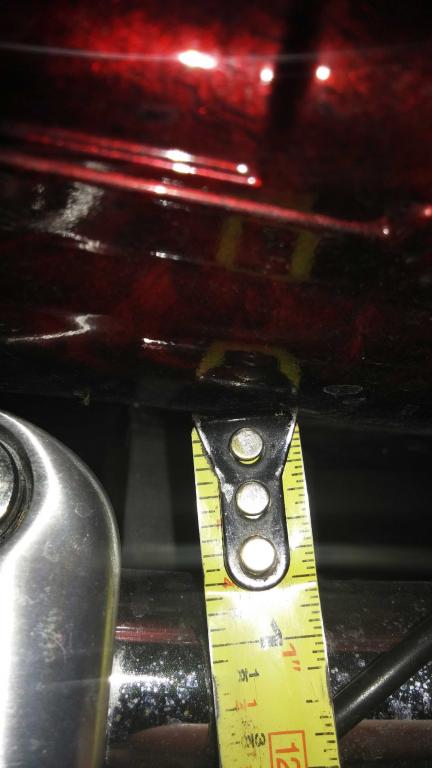

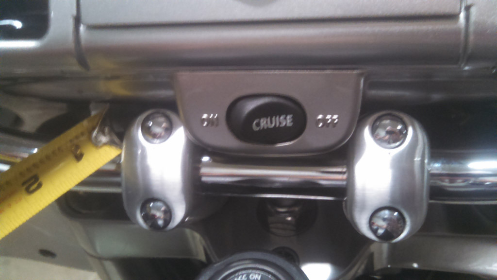

vzuden Posted August 5, 2015 Share #14 Posted August 5, 2015 VideoAZ, I was looking at your pictures, particularly where you have the tape measure in the view and this may be a dumb question but... Are looking to put the rubber damper between the bars and the fairing? The damper should be between the top of the triple tree and the fairing. M61AMECH's picture is the best of those supplied in this thread to show what it should like. He has extended his, of course. If you are already looking at that route, sorry to have stepped in. Link to comment Share on other sites More sharing options...
videoarizona Posted August 6, 2015 Author Share #15 Posted August 6, 2015 Gary, Good question. Was originally going to put something between bars and fairing. They are very close and with the way the fairing bounces without the original dampers in there...I figure I need something. The Risers are great for my shoulders but lousy for the fairing! There's no longer anything to hold the original dampers down by the triple tree and fairing...! Looking for ideas on what I could mount between bars and fairing (or anywhere else) that would support the fairing. Link to comment Share on other sites More sharing options...

djh3 Posted August 6, 2015 Share #17 Posted August 6, 2015 The 3rd pic of mine shows the spacer thing I got from Kirby. It fits where the hndlebars were orginaly. I think you could use a cheap socket that has the same OD. Then drill the riser in that half moon section and tap it to 1/4 20 thread, and run the bolt thru the socket and tighten. I think definatly the easy fix is the rubber spring spacer thing though. Link to comment Share on other sites More sharing options...
M61A1MECH Posted August 6, 2015 Share #18 Posted August 6, 2015 I used that black aluminum strap I made to hold mine together, you could probably use automotive strength double sided tape to hold them together. I was not overly happy with the asthetics of the pieces, but once they in there you can barely see them. I put mine on within the first year I had the bike and they stayed there for the next 6 years and 70,000 miles never had a problem. I considered the drill and tap to add the handle bar simulating piece that Dion mentioned, but with the risers being such a critical part of the bike control system, if one would fail because of that hole, you would be in a world of hurt. So my conservitive nature would not let me do that mod. Link to comment Share on other sites More sharing options...
