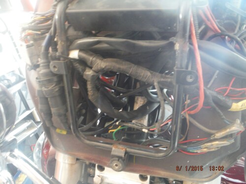

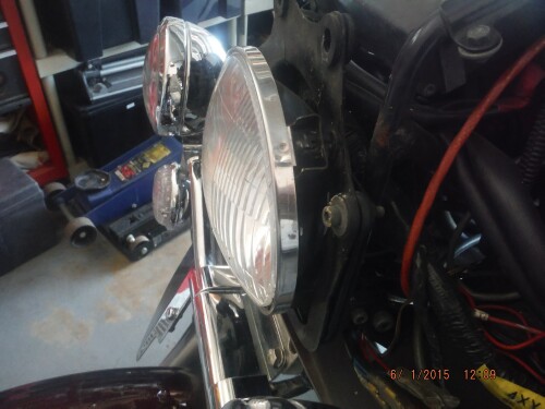

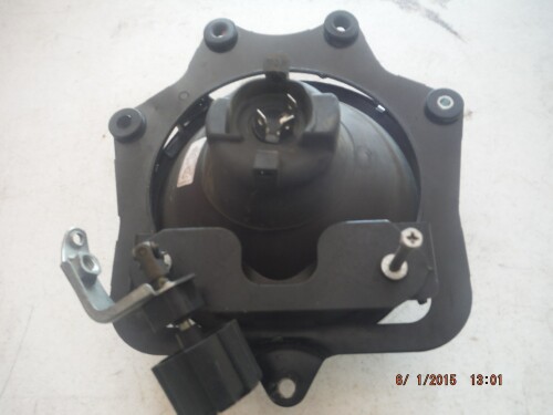

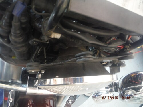

DSCF0321.JPGDSCF0322.JPGDSCF0323.JPGThanks Mike for posting my problem with the venture. I just got home from your house and took the fairing off, here is what I have. It does not look like the picture shown in the posting above.attachment.php?attachmentid=99621&stc=1attachment.php?attachmentid=99622&stc=1attachment.php?attachmentid=99623&stc=1attachment.php?attachmentid=99623&stc=1

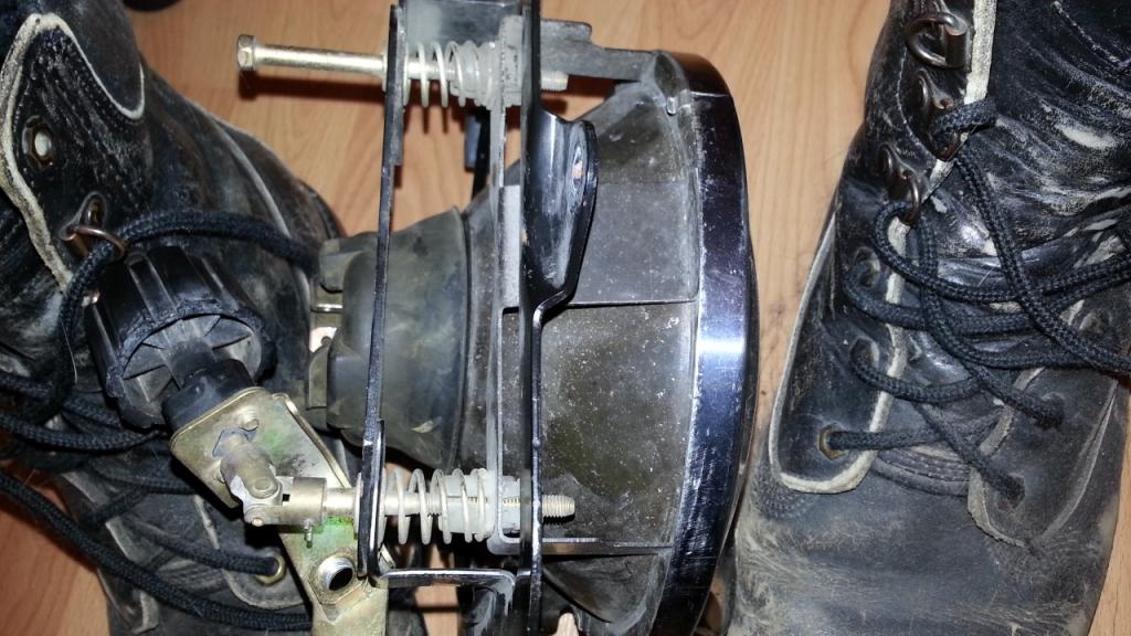

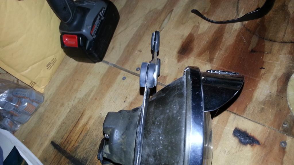

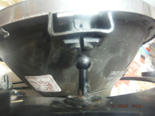

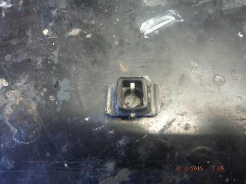

I think I found something that would push the Headlight forward inside the fairing. But I will need help to make sure if the ball rides on the outside of the tab or inside. I found the ball inside the tab when I took the bracket apart. If the ball rides on the outside of the tab, this would push the headlight forward. Does anyone know on there venture what it looks like??? DSCF0326.JPG

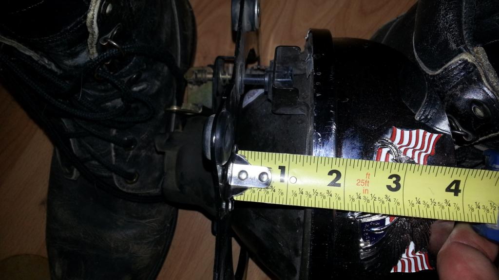

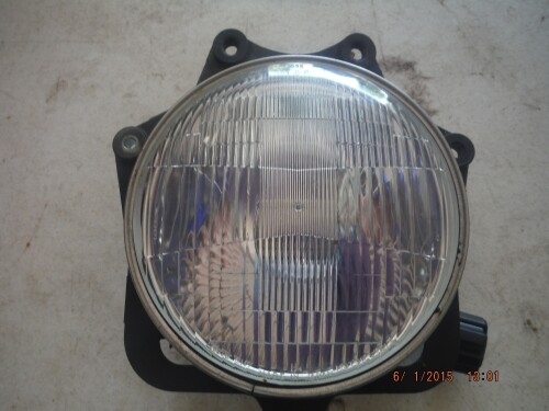

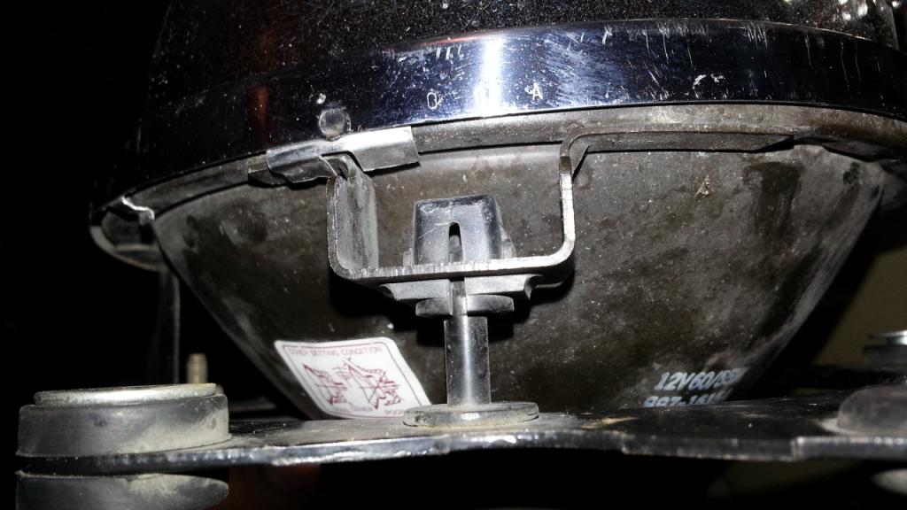

I have a couple more pics of my lamp
Looks like yours sets farther into the bracket than mine does
If you need any more pics, or measurements, let me know.
Gary, I'm no expert but that ball looks like part of the headlight adjuster and in stealthblades pics it is inside the piece on the bracket. His also has some kind of grommet or washer on the ball shaft. Could yours have come off or otherwise moved? If the ball shaft is adjustable is it all the way in or out?

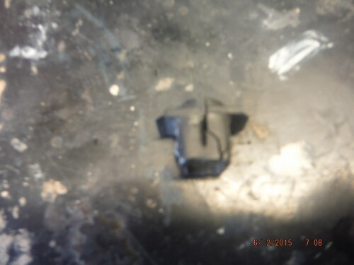

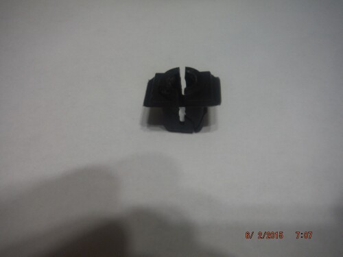

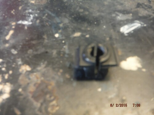

I removed the tab that holds the ball shaft and seen it was cracked. This hold the headlight assembly forward. The ball sits in a grove inside the tab. "NOW" were do I gat one of these? see pictures attached DSCF0327.JPGDSCF0328.JPGDSCF0329.JPGDSCF0330.JPG
I checked with Pinwall Cycle Parts and I would have to purchase a used headlight assembly which would be costly for just a plastic insert for the headlight assembly.
