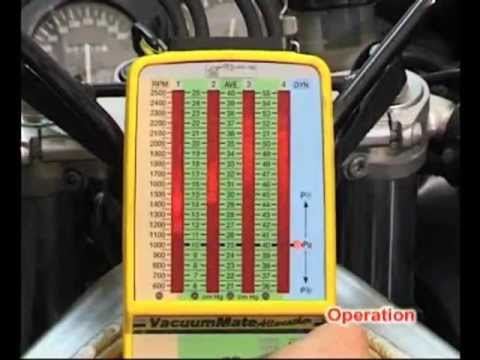

Bert2006 Posted May 15, 2015 Author Posted May 15, 2015 Well, was finally able to get to the dealer this morning. They took tire off and cleaned up the gunk on the inside of the rim (there was a lot, it is a wonder it held for as long as it did), they applied bead seal and then reinstalled and ballanced it. Hopefully this is now fixed. Time will tell! Also got my carbs synched and tech told me that I am well overdue for valves to be checked. He was saying this based on readings he was getting on the synch tool:confused24:. I am at 45000 miles and have no record of the previous owner having had it done. Will be bitting the bullet later this summer and get it done, was quoted min of 3 hours labour to do the job.
Flyinfool Posted May 15, 2015 Posted May 15, 2015 I've never seen or even heard of a sync tool that could tell the valve lash. Nor can I even fathom how you could tell valve lash from doing a sync. Me thinks you need a new tech that will not be pulling your worble. 45,000 miles or kilometers? Recommended time to check is 36K miles. 45K miles ya you are due for a valve check. 45K kilometers, is just under 28K miles you are good for a while yet. My bike is just getting its first valve check at 60K miles, there are just a few that are out of spec. I hope to finish it this weekend.
Bert2006 Posted May 15, 2015 Author Posted May 15, 2015 I've never seen or even heard of a sync tool that could tell the valve lash. Nor can I even fathom how you could tell valve lash from doing a sync. Me thinks you need a new tech that will not be pulling your worble. 45,000 miles or kilometers? Recommended time to check is 36K miles. 45K miles ya you are due for a valve check. 45K kilometers, is just under 28K miles you are good for a while yet. My bike is just getting its first valve check at 60K miles, there are just a few that are out of spec. I hope to finish it this weekend. I was puzzled by that too. He hit a switch on the synch tool that caused it to display something different, ie instead of the synching it was showing a range of something for each cyclinder or carb and 3 were showing multiple bars and one was not moving at all. He said this showed that one of the valves was tight....anyway it 45k miles so I will get them done. Now this tech is the best they have at this shop and so far has been straight with me, but I am with you on not trusting the story Iam being told....
Flyinfool Posted May 15, 2015 Posted May 15, 2015 (edited) Interesting tool. IF your valve clearance is bad enough to show up on that tool then you should not be running that engine at all. That tool can show a valve that is not sealing. As long as your lash is less than zero the valve will still close completely and should seal. That tool does not tell you what the valve clearance is. Only that a valve is not sealing or there is a vacuum leak in the manifold. So if the tool is saying that one valve is not closing, You may have a much bigger problem than needing the valves adjusted. Here is the manual that says what the tool can do. http://www.tecmate.com.au/pdf/vaccummate_TMNA_VMR6_eng.pdf Edited May 15, 2015 by Flyinfool
