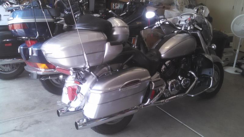

videoarizona Posted April 26, 2015 Posted April 26, 2015 Got her home, printed out a temp registration so I could get some gas and go for first ride. Thoughts: Totally different beastie from 1st Gen!! 1: Steering feels weird. Going into a turn..the opposite bar wants to pull on me...ie...it feels like if I let go in a turn, the handle bars would snap into the turn hard leaving me flying through the air. Slight exaggeration...but you get the idea. Both directions. Not neutral steering at all. Slow speed handling not as bad as I had heard once I put 42 pounds in rear and 36 pounds in front. Pirrelli's...relatively new. Front shocks at 0 lbs air and rear at 20 pounds. 2: Brakes are far better than 1st gen! 3: Not as much carrying capacity. No pouches, wasted space above feet on both sides where HD has cubbies. 4: I need to find one of these dampers: There are two...prices are totally different. I have one, the other is lost in neverland. [TABLE=width: 100%] [TR] [TD=colspan: 2][h=1]4XY-2317J-00-00 DAMPER 2. (under steering) Why different pricing? Look the same to me![/h] 5: The bottom of my two front cowls do not come together...looks like they should simply overlap then get pinned together. ??? 6: Need to find a tool kit for it or build my own.... Overall...an interesting ride for sure. Not as sure footed (yet) as my 1st gen....but much easier for me to deal with being so much lower despite additional weight. and yea, the gearing is a poor choice. MamaYamaha made a mistake there. They should have left the 1st gen's gears in. The RSV cruises nicely at 80mph....but does feel like it needs me to pay attention to the shift points at anything under 50mph. Gotta keep the revs up or she doesn't haul out like the 1st Gen does. Ownership: one day. Things will improve, I'm sure! david [/TD] [/TR] [/TABLE]

videoarizona Posted April 28, 2015 Author Posted April 28, 2015 Don, I ordered the lift adapter...should be in end of week. Will test front end next week. I'm used to the wandering from a loose front end, but this is different. Like the steering wants to snap further into the turn than I am doing. It's pulling into the turn in both directions. That part is a bit scary for me as I've never had a bike do that. david

videoarizona Posted April 29, 2015 Author Posted April 29, 2015 Seaking, Does feel kind of like an over steer. I looked the tire over but nothing can be seen that I recognize, other than it's worn. It's at the point where the wear marks are just showing. As soon as I get the initiative to take off the front tire and both rotors...I'll get the tire to a dealer to mount the new tire on. I have no history on bike's travels or issues other than PO saying the bike was in great shape. Don't know about geometry or any mods. I was hoping someone else would have a similar experience and point me in a direction. I did add more air in front tire...now up to 38 pounds. Will ride tomorrow in morning if winds allow and check out the steering again in slow turns. Such a weird feeling though, to initiate a turn then have the handlebars trying to move into the turn even more! I'm hoping there isn't any fork damage....I don't see anything... david

videoarizona Posted May 13, 2015 Author Posted May 13, 2015 Put the lift brace underneath yesterday and checked out my motorcycle lift. First time it's been used in two years. Pushed 2nd Gen up fine. While up, checked front end bearings. Feel good but were loose. They would rebound back and forth and not stay put in center. Took 1/4 turn to tighten the bearings up enough to where she would hold still in center and rebound properly. So they were quite loose. Next up, take the front wheel off and get it to the tire shop to mount the new tire. While it's there, I'll work on lowering the forks in front.....
