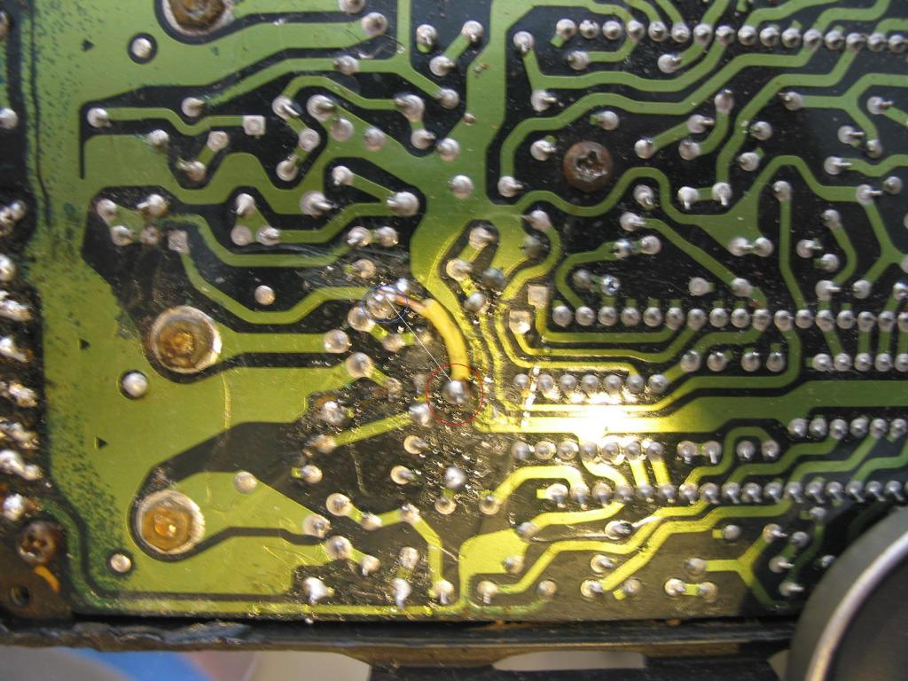

Vonwolf Posted July 6, 2015 Author Posted July 6, 2015 With my carb problems over I look into the ageing TCI and after I opened it up found that 8 diodes had exploded so I ordered the diodes should get them nex week, I hope I can save my TCI, we'll see. While I'm waiting for the diodes now would be a good time to tackle the rear breaks, the front breaks and the clutch were an easy fix so I was hoping the rear would also turn out simple? Well not so much the master cylinder had transformed into one solid block of aluminium completely fused together and the reservoir's 2 screws for the lid were, of course stripped out I had to drill them out big fun. I fixed the reservoir but the rubber gasket is fully expanded and will no longer collapse into itself making it useless. I guess I need the whole setup master cylinder and reservoir if anyone has one they don't want anymore let me know
Vonwolf Posted August 4, 2015 Author Posted August 4, 2015 (edited) Might as well update things, I think my TCI problems are behind me now after a whole lot of unnecessary experimenting, wasted time and money the way it normally goes on a budget. I first tried to repair my original TCI as the diodes were all turned to white powder. I'm a carpenter/ home builder by trade my soldering skills might not be the best, but I got things done. I got the motor to run great on 3 cylinders but the number 2 just would not run, it got spark but just wasn't carrying its load. I'm sure those burned out diodes did the TCI no good so I'm sure just my sloppy soldering skills weren't enough to bring it back to complete functionality. A replacement TCI seemed to be needed so on to eBay where I got one for a good price. It looks to be in good shape, much better that mine, but turned out to be a brick. Naturally the seller would not stand behind his product so I had to turn to Ebay, I accepted a %50 refund offer because I was dying to see what the board looked like with the hopes of fixing it. Not likely, I don’t know how it can look so good on the outside and be so messed up on the inside, but she was burnt badly, I’m still going to replace what I can, but I don’t hold out much hope for it. Strike one! I found another TCI still priced reasonably so I placed a snipe and left it alone. I turned out to win that and while I was waiting for it to be delivered I thought I’d change out the spark plug cap and wire as it was giving me a good jolt when I’d pull it to see if the RPM dropped. The bike now runs on all 4 cylinders probably for the first time sense I have owned it. The new TCI arrived Monday and Wow I’ve only seen pictures of units that look this nice, it’s defiantly my main unit and the original is the backup. I know the smart thing to do is check the diodes before they do go bad, but this thing is nice and I messed up one foil lead on the original board (Not real good solder skills) I don’t want to mess this one up although I was able to fix the foil by soldering in a wire to bypass it and they both work great-http://i1064.photobucket.com/albums/u369/vonwolf1/IMG_0002%20Marked.jpg So I just have to put the rear brake back on and start putting things back together, after I paint things. Lots of work left, but I'm sure the motor is going to start every time and it runs great. I wasn't ging to do anything to a near 30-year-old bike if it wasn't dependable. I just realized I've never posted a picture of her when I first got her- http://i1064.photobucket.com/albums/u369/vonwolf1/BUw9g3gCGkKGrHgoH-EYEjlLl0H2jBKPNQYDSnw_12.jpg It's a terrible color and I let it sit covered up for years because of the old 2 brush starter and all the nonsense that caused so the poor bike's not as shiny as it was. I hope with a decent paint job it will look as good as it runs Edited August 4, 2015 by Vonwolf

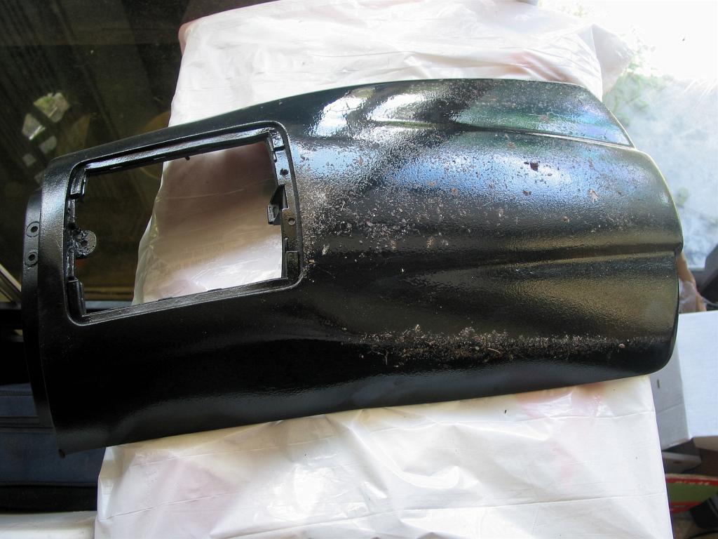

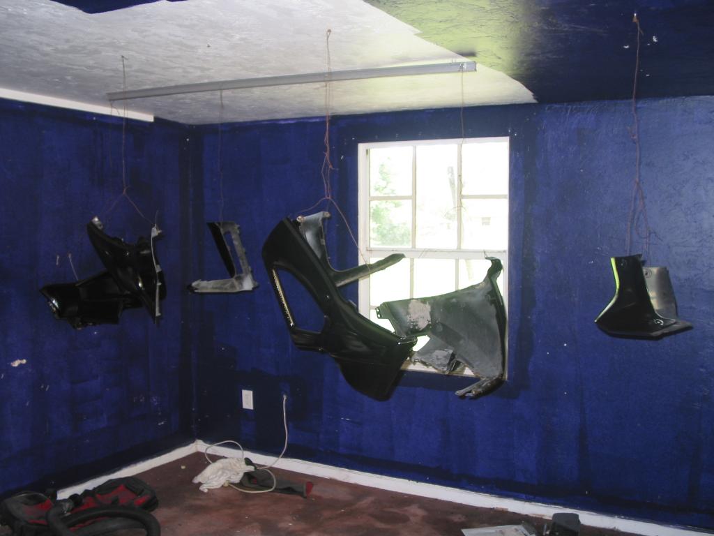

Vonwolf Posted August 12, 2015 Author Posted August 12, 2015 I finally got around to painting the fairing pieces with Jet Black lacquer base coat/clear coat, it came out ok, nothing like I'm going to win any shows ar anything, but it looks good for being mostly a pile of cracks and other repairs. I suspended the pieces from the ceiling so I could do them all at once and it worked well for the most part- Of course one piece, the false fuel tank not only fell it landed paint side down- Looks nice, right? I used all my paint sooo it looks like it's going to be repainted with a couple of spray cans till I get around to the rear bags and trunk when I have to buy more paint. The sad thing is the tank was already painted black and looked ok I just wanted it all to match. I'll get it right someday I'm sure
Flyinfool Posted August 12, 2015 Posted August 12, 2015 OH bummer. I hate when that happens. If you are real lucky, the black underneath is still ok and you can wet sand most of the crud out of the clear. Maybe touch up with a clear buzz bomb.
Vonwolf Posted August 12, 2015 Author Posted August 12, 2015 OH bummer. I hate when that happens. If you are real lucky, the black underneath is still ok and you can wet sand most of the crud out of the clear. Maybe touch up with a clear buzz bomb. That's what I was hoping for, but some of the junk wicked the lacquer thinner out of the clear coat and melted its way to the primer. I have lots of sanding to do, at least its not a very big part and who looks at the top of these bikes anyway? I'm sure no one will notice
