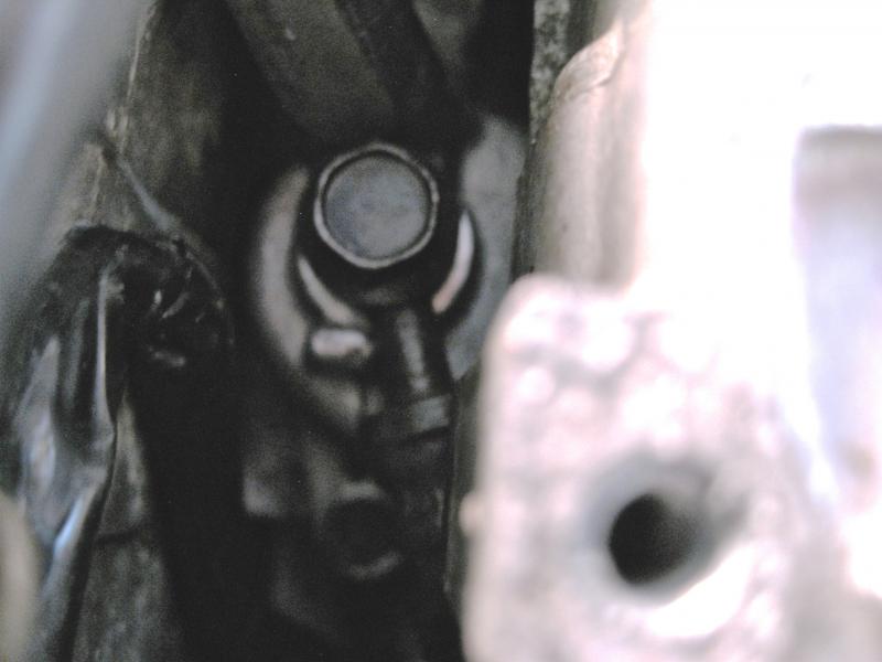

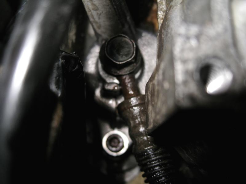

flyday58 Posted February 10, 2015 Posted February 10, 2015 Here's some views of the clutch slave cylinder. It's located behind the left rear engine cover. You'll need a 5mm hex wrench or socket to get the two bolts out, they're not easy to see. Break the banjo bolt loose first, 12mm socket. Then scrunch up your toes and hold your mouth just right and it will finally come out. Trust me. I replaced the seals initially but it continued to seep brake fluid so just got a new one. Good now. As for brakes, they were the reason mine was sitting for five or more years. They'd locked up on the PO so he parked it under a leaky shed. I had to ebay all three wheel cylinders, both handlebar master cylinders and the rear master cylinder. The rear broke in half from aluminum rust when I tried to take the servicing bolt out, how's that for too far gone? Got it all off ebay for not too much money. Yours may not be that bad off but mine sure were. Probably shouldn't have put this much money into something in such bad shape. Keeps me out of the bars and hostels, though.

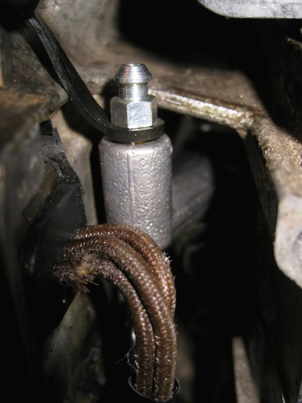

van avery Posted February 11, 2015 Posted February 11, 2015 On bleeding your clutch. If you look on the left side of the bike on top on the middle gear cover is a small rubber square with a bump in the center. pry it up and you will find the clutch slave cylinder bleeder just under that rubber cover. Bleed it just like you would a brake system. Most likely you should start by cleaning out the clutch master cylinder and then add new fluid to the resiviour then open the bleeder on the slave cylinder hopefully with a tube into a glass jar and bleed till the fluid runs clearer like what your adding the system. Good Luck
Vonwolf Posted February 11, 2015 Author Posted February 11, 2015 Thank's I'll get on this today, I still can't beleave I did this I'm sure the clutch was working, just not like a break. I don't have any plastics on the bike so I sprayed the hell out of both reservoirs, blew air in them and things are really clean, but I was covered in fluid. I think I might get lucky and still have everything working, but luck is not my strong point so time will tell.
