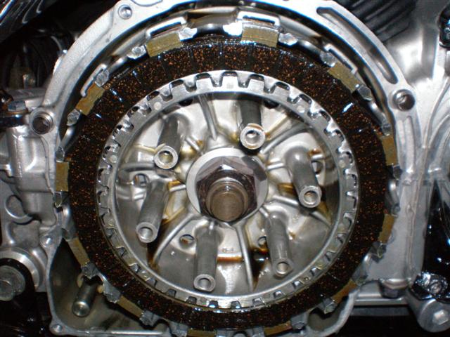

Only if you need them.
A new disc will not grip any better than a used disc that is still in spec.
OEM friction discs are 3mm (0.1181 inche) thick, worn out is 2.8mm (0.1102 inch) thick.
My discs measured 0.1170 inch thick at 45,000 miles. I reused them.
Link to comment
Share on other sites
I did the same thing as soon as I got the bike and before the actual conversion. My bike had 9500 miles on it when I got it but knowing the extra load being put on it I did it now rather than later. On my 05 the clutch started slipping at about 30k .
Larry
