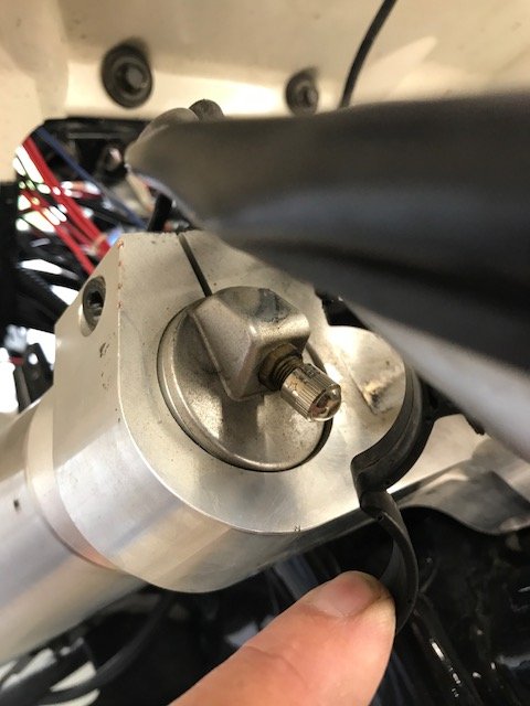

Spacer Cut is 6.75 inches. Using 15 wiehgt BelRay fork oil. 18 oz Yeah Don, I think these should be fine since the bike is triked I had Already ordered them and got them for $52 so I hope they work for my Bottoming out , otherwise my steering is upright at all times , no leaning. -

cut it out just now, thanks, and my forks have a drain plug in them at the bottom of each fork... what size did you guys cut the plastic tube for the progressive springs ? and did you use to same amount of fork oil ? -

Hey Old Boy. Hope all is well with you ! Yes, that is a great jacking point on both side. However I have it on my MAXJAX right now. now that rocks. LOL So far have have the springs out, and the top tree off, waiting on a new bearing tomorrow and the race it goes into, and some other parts. Gunna try and drop the shaft down so I can at lest pack in some grease on the bottom bearing for now I guess, not sure I wanna mess with changing out the lower yet. Just trying to figure out the best way to screw that darn caps back on when I put the new springs and oil in :-) that otta be fun. Oh and I am not pulling the forks all the way off as well. Anyways, nice to hear from you. I guess nobody loves me anymore, only 2 folks that I know have posted back to me in this thread. guess I did something to piss folks off ? I dunno. oh well..... Jeff -

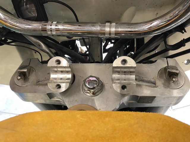

Sweet , Just removed one of the springs :-) I am in this far , how hard is taking off that tree top and replacing the bearing or re-packing it ? Any tricks? -

If good ,I will now remove the other messes, and the bars, think I will put in a new bearing as well. maybe hang the bars from the garage ceiling . -

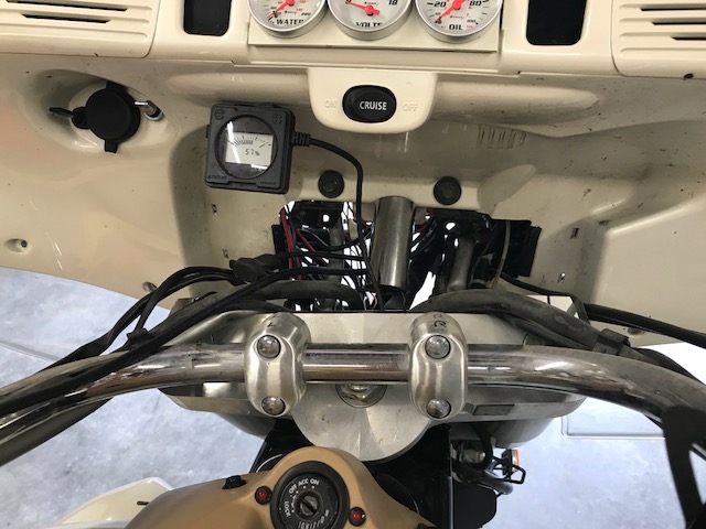

up in the air now , front fairing removed but the part of remove whatever bolts for the rear fairing is the problem. guess I will have to figure it out on my own. :-) and I promise not to take any pictures LOL -

I can not seem to find the (how to install progressive springs) on the 2nd Gen.... Can this be done with-out removing the inner fairing ? Or can anybody guide me to the procedure ? Oh, and is the number for them 11-1144 ? Thanks for any help. Jeff
