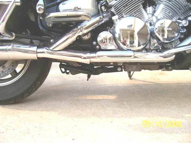

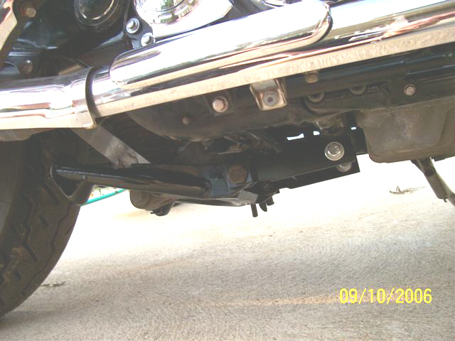

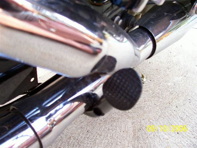

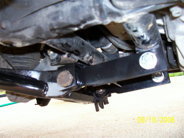

FuzzyRSTD Posted May 18, 2011 Author #22 Posted May 18, 2011 Mikealiasmike said: Happen to have a pic of one of yours on a Venture? Mike, there is some good picks here at the tech library. Freebird made a " good show me how" on these stands with pictures.Hope this helps. Fuzzy
Squidley Posted May 19, 2011 #24 Posted May 19, 2011 Ponch said: here's some shots from Freebird's tech write up. You are so helpful.....EEGIT!!!!
Ponch Posted May 19, 2011 #25 Posted May 19, 2011 http://i302.photobucket.com/albums/nn107/billycooper_photos/AwShucks.gif
