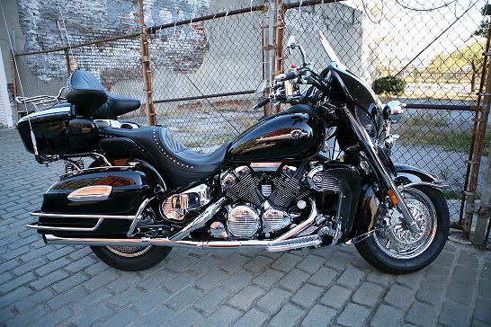

yamahamer Posted November 19, 2008 #11 Posted November 19, 2008 Thanks for all the replys to my questions. Was not looking or trying to improve air intake or make any more gitty up and go. Just wanted to make her look pretty!!!! Thinking some other air filter/pod (chrome) or filter kit like "RamFlo", "MaxAir" would do it. Just can't dig deep enough in my wallet to get Yamaha's filter covers and to boot the extra expence of K&N air filters $$$$$$. Will have to turn my thinking cap around and go another direction!! I have noticed that out of all the pictures of RSV and all the accessories that have been put on them non have had anything but Yamaha's billet covers. It's a shame that this is the one area of the bike that can't be or is the most difficult to dress up. If your looking for more chrome dress up you can make a big wish list by looking at Scott's bike. user name "got2mnytoys" It's the most dressed I've seen yet http://www.venturerider.org/forum/member.php?u=5259
KiteSquid Posted November 19, 2008 #12 Posted November 19, 2008 (edited) Why not make your own air filter housings and use the factory filters???? Buying chrome out of a catalog is nice. IMHO, making your own billet aluminum or chrome pieces is true customization. however the only customization I have done are safety improvements. Stable horn, extra tail light, replacing the lamps with brighter ones, etc, and some maintenance improvements like using Honda Moly60 on the splines. I guess I would rather put my money into the tank and a hotel room for an overnight ride rather than to bolt on some chrome, but it is all personal preference. Please post some photos of whatever you do to your bike!!!!!! Edited November 19, 2008 by KiteSquid
Gearhead Posted November 19, 2008 #13 Posted November 19, 2008 Thanks for all the replys to my questions. Was not looking or trying to improve air intake or make any more gitty up and go. Just wanted to make her look pretty!!!! Thinking some other air filter/pod (chrome) or filter kit like "RamFlo", "MaxAir" would do it. I don't understand. Isn't the airbox buried under the tank? Don't the carb inlets face straight up under the tank like they do on a 1st gen? As such, how is an aftermarket chrome air filter even going to be seen? Running the numbers here for CFM for a 1st gen (7000 rpm) gives 160 CFM. If V.E. is 80%, multiply by 80%. 2nd gen is probably similar. But CFM ratings can be deceiving. Flow has to be rated at some consistent pressure drop to be meaningful. When a company says they can flow "X CFM" but they don't give a pressure drop, they might have to pull 7 psi of pressure drop to get that flow which is not what you want. One example of inconsistent standards is 4 vs 2 barrel carbs. 4 barrel ratings are pretty consistent at, I think, 1.5" of water pressure drop (a very small amount). 2 barrels are less consistent, but often rated at 3" of water, twice the drop. So if a 4 barrel and a 2 barrel had the same numerical flow rating, say 400 CFM, the 4 would actually flow more freely because its rating is achieved with less drop. Back before 4 barrels were common, there existed flow benches for testing carbs and the standard drop was 3". As engines became more powerful and 4 barrels came on the scene, the flow benches couldn't pull enough air to get them up to 3" drop so they used a different standard, 1.5". Jeremy
