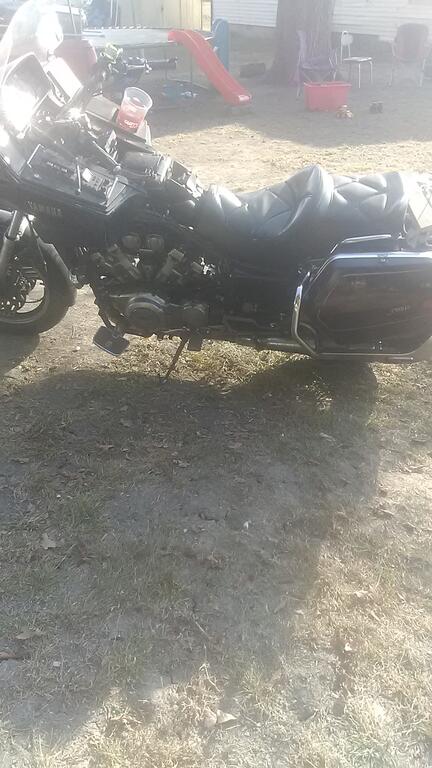

Pops and NaNa here. Got a 83 xvz12 on 3/10/2020. W/ 32k w/o#2 gear. Dirt dirt cheap. y'all said buy it. Skip 2gear. We did. Bike has 39k. We love the way it Rides. Wore out the rear tire. Just rode from C.J. to N.E,Mo. 600m round trip. With wife and camping gear to work. Last week. The bike loves the hiway. Hitting 110/115 and w/o knowing it. Rides that smooth. Anyway next day . Puff white smoke.. need help with ordering the right gasket set and anything else I might need. Cause redneck bikers can fix anything. Lol let's have some fun.
