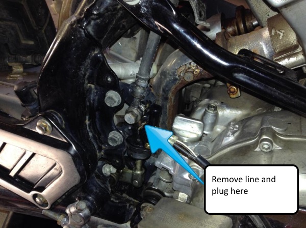

on the rear, this is where the front brake comes into the rear m/c.
http://i36.photobucket.com/albums/e48/mcgyverit/3222e261-63ad-4eba-9d3a-2c466d49e175_zpsbb142f5a.jpg
this is where the rear is coming into the rear m/c block
http://i36.photobucket.com/albums/e48/mcgyverit/50c22693-c4f7-42a2-99aa-33ff19e70663_zps9be45810.jpg
I tried to take the rear line off and hook it to where the front is mounted but it doesn't reach. so can I just plug where the front is mounted?
