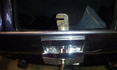

ragtop69gs Posted March 25, 2013 Share #77 Posted March 25, 2013 Here is a picture of the lock I'm going to try. It's used on vending machines, it uses a barrel style key lock. Turn the key and the lock pops up, turn to open trunk, push down to lock. I'll have to make my own cam. I like the low profile look of it when locked. Link to comment Share on other sites More sharing options...

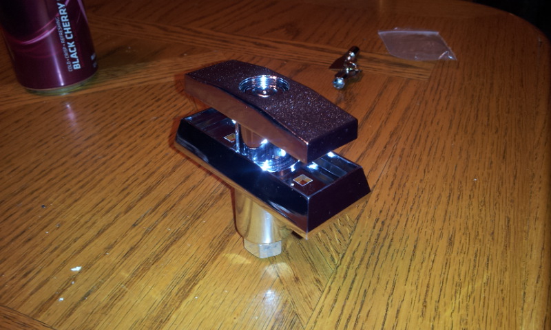

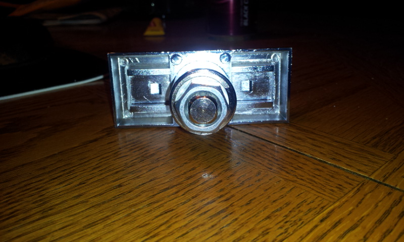

Cougar Posted March 25, 2013 Share #86 Posted March 25, 2013 OK Gang, here is a pic of both large and small locks with the OEM cam in the middle of the mess. at lest you have more working room with the larger cam that comes with the unit on the right.. I will be cutting mine to match the OEM cam from the larger cam. the small just almost works but barely. I also will be using the extra nut from one of my small units so there will be two to make a better locking as well. [ATTACH]75092[/ATTACH] Let use know how you did yours and your tips and tricks please. Jeff Link to comment Share on other sites More sharing options...

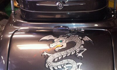

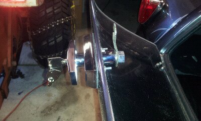

Cougar Posted March 26, 2013 Share #88 Posted March 26, 2013 OK guys mine installed pretty easy today, took about 40 Min's as I had to cut and file the cam to my liking. Have fun. glad this project is OVER Works great Here are some pics to maybe help someone in the future . Jeff [ATTACH]75110[/ATTACH] [ATTACH]75111[/ATTACH] [ATTACH]75112[/ATTACH] [ATTACH]75113[/ATTACH] [ATTACH]75114[/ATTACH] [ATTACH]75115[/ATTACH] Link to comment Share on other sites More sharing options...

ragtop69gs Posted March 28, 2013 Share #94 Posted March 28, 2013 Here is what Im going to use. Came in the mail yesterday. Link to comment Share on other sites More sharing options...
Cougar Posted March 28, 2013 Share #95 Posted March 28, 2013 that depth long enough Link to comment Share on other sites More sharing options...
ragtop69gs Posted March 28, 2013 Share #96 Posted March 28, 2013 that depth long enough Same as the hannigan lock so it should be. Link to comment Share on other sites More sharing options...
alwrmcusn Posted March 29, 2013 Share #97 Posted March 29, 2013 New T-Bar lock installed. Easier than I thought. Link to comment Share on other sites More sharing options...

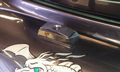

ragtop69gs Posted April 5, 2013 Share #99 Posted April 5, 2013 (edited) I got the trunk lock installed. Here are a few pictures, what ya think ? I had to make my own cam for it. Edited February 13, 2016 by ragtop69gs repost pics Link to comment Share on other sites More sharing options...
Cougar Posted April 5, 2013 Share #100 Posted April 5, 2013 Really Nice Job ! Looks Great Link to comment Share on other sites More sharing options...
