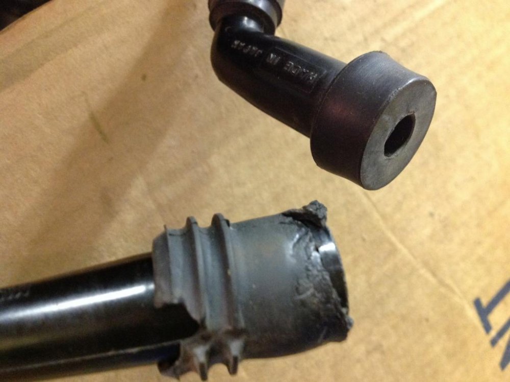

My back two plug boots have deteriorated (due to heat) to the point parts of them are stuck to the head. The thumbnail shows one of the deteriorated boots and one of my front boots. I'm thinking the back two are not original. Any thoughts? Can I buy just the boots?

The back two plug caps which have the springs have the discs. My thinking is that it is a buffer between the spring and resistor to avoid abrasion to the resistor. -

When I took the plug cap apart there was a small brass(?) disc that came out. I didn't notice it at first so don't know where it goes in the line up. I'm guessing it protects the resistor from abrasion by the spring. Took the other back cylinder plug cap apart but didn't see that small disc right away either. Thoughts? -
