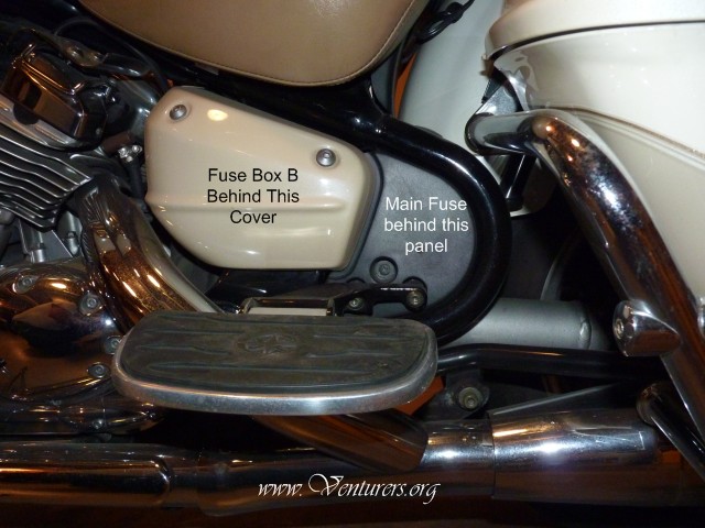

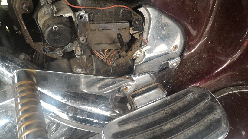

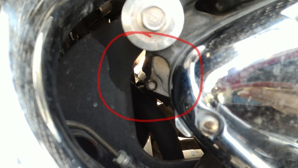

Apologies to everyone for taking so long to get back to you on this but the trike isn't the only "iron in the fire" I have going on around here. Add in, the hubby actually decided to help and that in itself took time along with my reminding him about it every three days or so. Here's where we are. For starters, I think I've got the starter located. Thanks Jeff for the pic. If I'm not mistaken, the little bolt I've got circled in the first pic is the starter. But that's as far as I've gotten with it. I was in the chat one evening and ended up talking to Greg, aka snyper316. He pulled up the Venturers website which had pics showing where the bike's three fuse holders are located, one of which includes the solenoid. That's the second pic. Only problem there is that with the trike kit, the panel it hides behind isn't there! What I've got is the third pic. What has taken so long is my/his multiple attempts to get the passenger footrest pulled so we could get the chrome panel I have off. The footrests are what I'm assuming are Kury. highway pegs attached to the footrest which combination has two bolts in it. Somebody got real energetic and "Loctited" the heck out of them. I couldn't get them loose so this is where the hubby stepped in. His first attempt was using a cordless drill on one and he stripped the head out. So I've been waiting on him getting them out. Greg suggested heating them up first but that was something of a problem as we also had to protect the paint on the trike kit which is very close to the darn bolts. We finally did it!! End result is we find another bolt in the panel that has a countersunk head on it and the nut holding it in place also appears to be the same way on the back of the panel making it almost impossible to get off! However, I can move the panel around to see behind it. No main fuse/solenoid in that location. Oh Fun! So I start digging. I pulled the battery holder out and guess what's mounted to a little rubber bracket underneath it? GRRRRR Ok NOW I've got it located!! I'm checking the cables and it looks like I'm going to have to do a little jury rigging to get the battery hooked back up so I can test it. The main battery cable to it is so short that to get power to it, I'd have to put the battery back where it belongs which would block my access to the darn thing. There's not enough give in the two cables to hook it up outside the bike so I'm going to have to find a pair of baby jumper cables and do it that way. I'm debating going ahead and replacing the solenoid and the two main fuses just for the heck of it. $10 is not going to break the bank. Besides it will make sure that those connectors are clean. The fun will be getting the lil monster back in it's bracket when I put the battery compartment back together. Another problem is replacing the two bolts. While they are standard hex head bolts, I have been unable [so far] to find bolts that length or thickness. And so it goes!! I'll keep in touch and let you know how this mess is going. Again as usual, all help gratefully appreciated!! [ATTACH=CONFIG]108746[/ATTACH] [ATTACH=CONFIG]108747[/ATTACH] [ATTACH=CONFIG]108748[/ATTACH] -

Here we go again. I still have not located the starter. The trike is currently sitting on my flatbed trailer which isn't much bigger than the trike. Getting to the front underside is a major headache as the trike kit effectively covers whatever the stock bike does not in that area. Add in the radiator cover on the front and it's pretty much enclosed. There is a rubber guard around something directly below that but I'm not sure what it's covering. The only way to get under there would be to unload the bike to jack it up and that's not something I'm in favor of as two 60 somethings trying to reload it [providing of course that I can get the hubby to help] could get interesting. I used my usb camera on it this afternoon and still can't be sure of what I was looking at. GRRRRR I have no problem spotting the oil filter so if someone can give me directions from there I'll try again tomorrow . FYI guys, the hubby is no help. The bikes, among other things, are "my thing" not his. He won't touch them. It's why I've had a bike [my RSTC] sitting for the last 3 years. I'm still kinda surprised the trike was running as I had to spend several months in 2015 up in Illinois on family business and he actually went out and started it for me. Otherwise it would be in the same shape as the RSTC. Add in the fact that a mechanic I am not. Doing this stuff "cold turkey" is scary . I'm concerned I'm going to screw something up. The starter should not be that much of a problem once I figure out where the darn thing is! The bike needs to go back to the paint shop which is one reason why I haven't unloaded it. If I do, that trailer is for sale and I'm getting a bigger one. I'm having to pad the back edge of the trike to prevent the tailgate/loading ramp on the trailer from chipping the paint. It's a snug enough fit that I had to pull the hitch bar out of the receiver to get the ramp up. As to why it needs to go back? I had a lil fender bender on it back in November. Between the holidays and the paint shop owner spending most of January in the hospital, I didn't get the bike picked up until a few weeks ago. Somewhere on the road home, the bike shifted over enough that the right rear wheel cover ended up against the right side rail [angle iron] and did a nice job of scraping my new paint job up. [i told you it was a snug fit!] As always, all help gratefully appreciated. -
