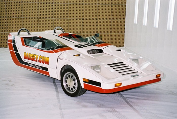

So I was researching trikes and I came across this trike from the '80s powered by a Venture. I thought I would share this, it is kind of neat. It is a Badsey Bullet.

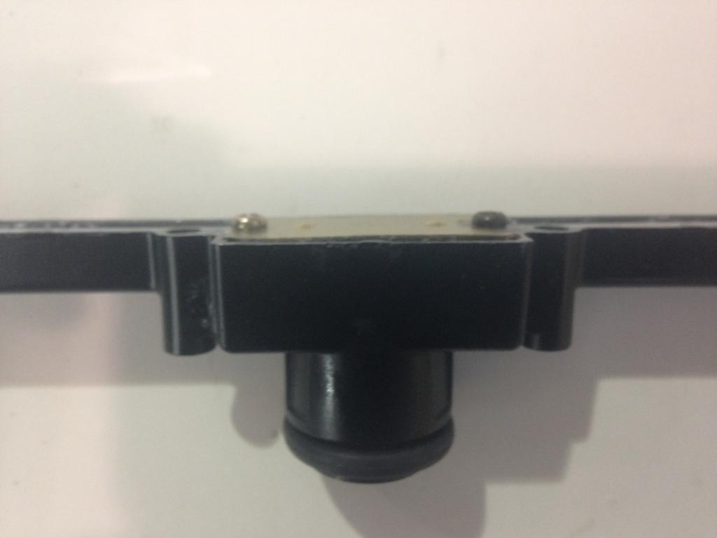

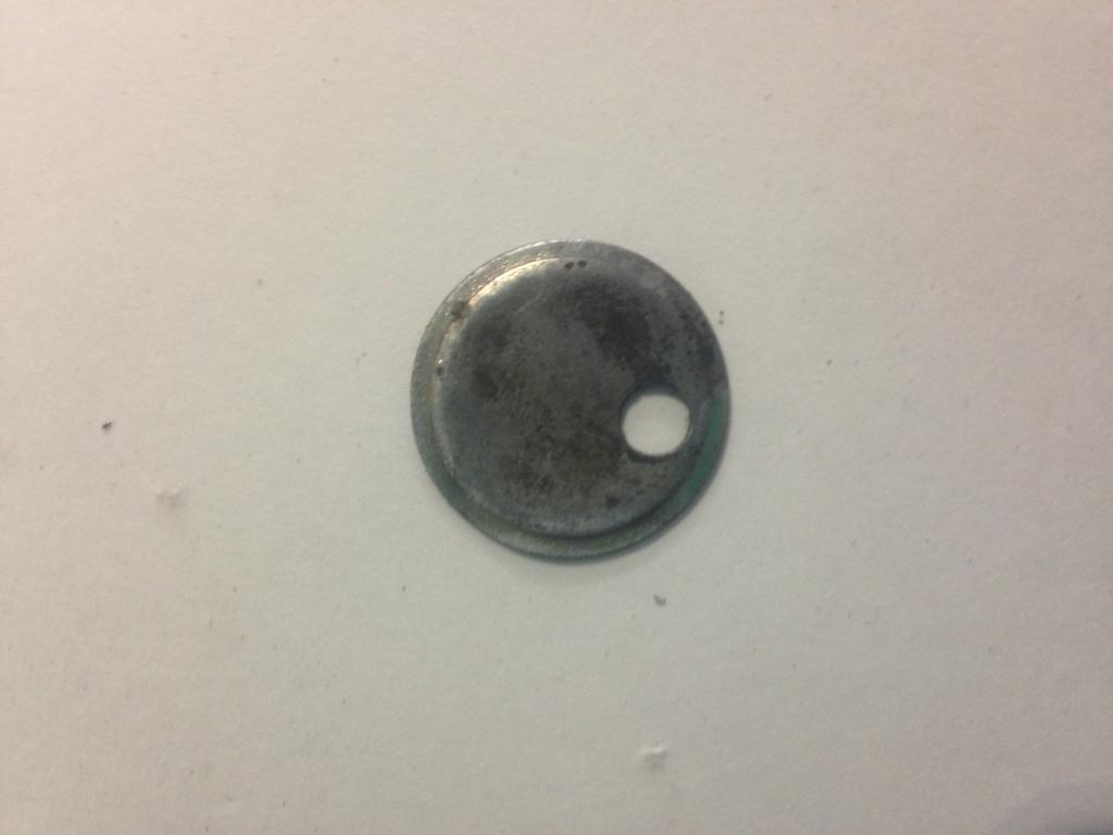

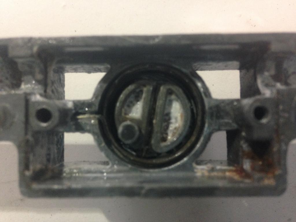

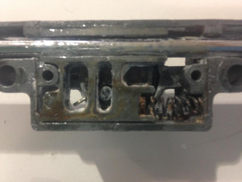

OK, so I finally got around to working on my saddlebag lock. I took it apart again, this time taking pictures. In the first picture you can see where the spring is sticking out from under the round retaining disc, on the left side of the pin. The second picture shows how the spring is seated in the lock. The third picture show the orientation of retaining disc, (I had mine upside down) the final picture is with everything closed back up. Before closing everything up I lubed the moving parts with 3in1 white lithium grease. I tried a spray on dry graphite lubricant but it didn't work well. Hopefully someone will find this useful.
