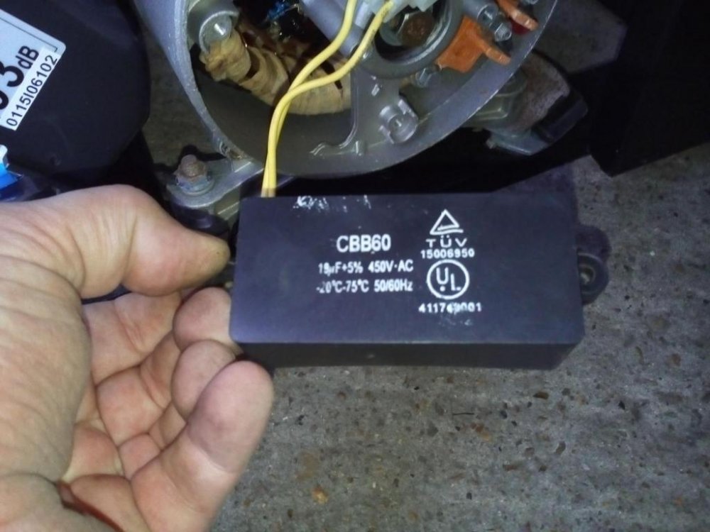

Fixing a rubbish petrol generator
greg_in_london replied to greg_in_london's topic in General Tech Talk
Follow-up: I bought a cheapie capacitor which was the same specs, but bigger, and fitted it. Apart from soldering a wire to a switch and taking a bit off the end of the HT lead to make it start more reliably, fitting the capacitor seems to have done the trick. Unfortunately I won't know for sure until we're surrounded by friends, drinking beer and powering a PA system for our party, but it will all add to the fun ;-) -
I've ordered a couple of capacitors - 19 and 20uF. The ones with the highest specs are the cheapest as they're coming from China, the ones in the UK seem okay. Either way I'll have one to try in a couple of days and spares on the way. I found a place that seemed really good on generators, if quite expensive. They recommended an AVR (automatic voltage regulator) instead of a capacitor (at extra cost), which I was going to spring for until they tried adding extra taxes between checkout and paying. I HATE that - generally they're not allowed to add prices to what is displayed over here, so it's a really stupid practice. Hopefully the capacitor will do the trick. Thanks for the link, flyinfool - I saw that page, but the gennie stopped working in use, so I thought a lack of charge was unlikely. I'm going to use the multimeter tests on the brushes though when I dive in with the capacitor. Another site suggested checking the generated voltage without the capacitor, which they said would be about 5v (as the capacitor provides the energy to excite the coils). I'm a bit nervous of that, but could do it so long as I can make the connections before I start the engine... -

Does anyone have any expertise with petrol generators ? A few years ago I bought a Pro-user G2300 2.3kW petrol generator. I finally used it on a camping weekend last summer and then a couple of times to power a drill in the garage. A couple of weeks ago a friend borrowed it to play some music at an event and it stopped working - the motor runs, but it doesn't generate electricity. I haven't done any electrical tests yet, but when taking off the vent cover from the generator I also took off a black box which seems to contain a capacitor and the plastic backing bit which should weather proof it has been pushed out and maybe a component inside is erupting, so it's either very poorly made or the capacitor has popped. I presume that that would stop the generator from producing electricity, even if I'm not sure exactly how that would work. I'm just wondering if anyone has experience of generators could tell me if the cpacitor is really likely to be the problem. Presuming that it is, can I just replace it with another capacitor of around 19uF ? is there anything I need to avoid ? Or is the problem likely to be something else so the part will pop again unless I sort it ?
