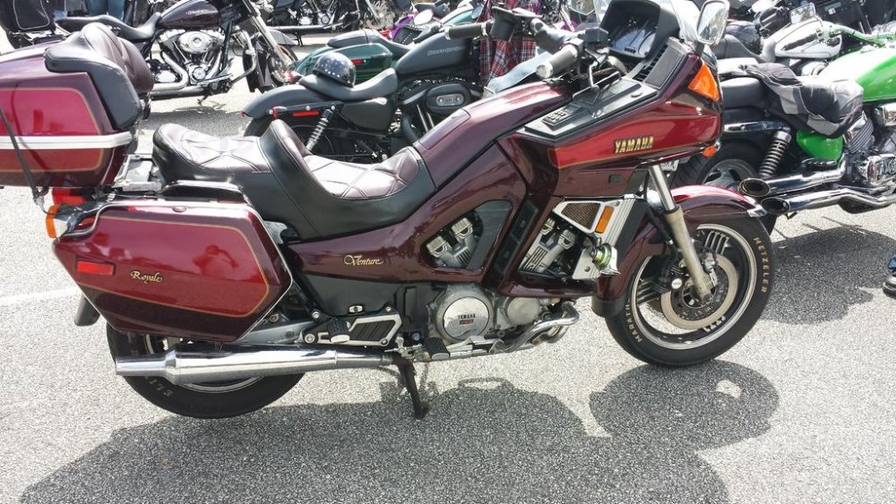

  3. My 84 at Daytona last year.

  9. Took plenty of pictures from the bike but none of the bike you can make out. Was the ONLY 1st gen there. My bad.
