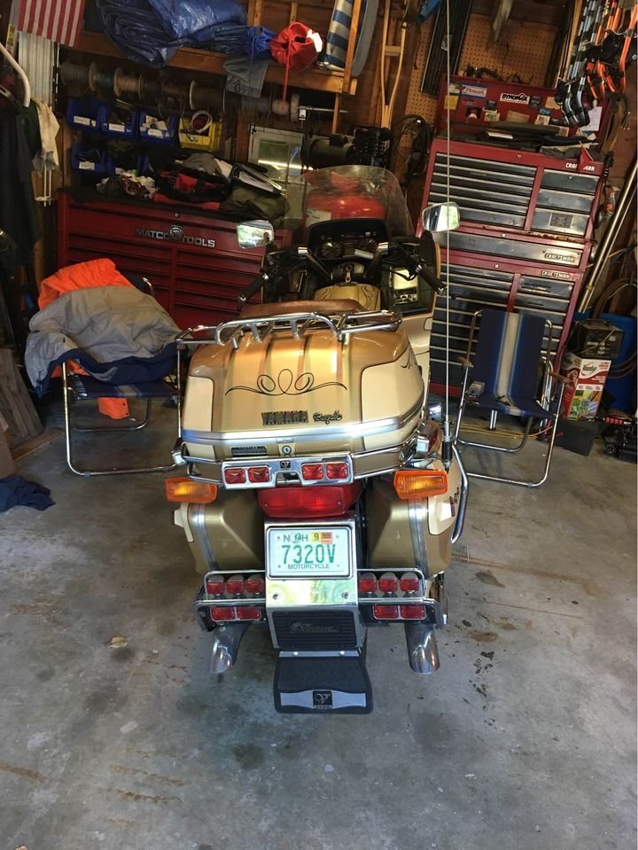

  10. Ref picture below. These red lens covers on the Drag specialties rear end are now almost 40 years old and a few have cracks etc. Anyone know where new ones can be obtained?

  17. Some good ideas here. My 83 has ALL the Drag specialties accessories which ALL have lights in. The rear is something silly like 12 lights. I did try to add LED bulbs but it is going to need some electrical work to make that work. My snow plow (belly pan) is currently being powder coated and I will be putting LED's in that when it comes back.
  18. Thanks, that's a good yardstick. I bought my early 1983 VR with 39k miles for $1200. It had sat for about 10 years, but almost no damage anywhere (couple of plastic cracks) and all original books and accessories (I even have the chainlock that uses the original key!) - Just getting started on it. Needs tires, servicing and a good carb clean - it runs, but not well.
