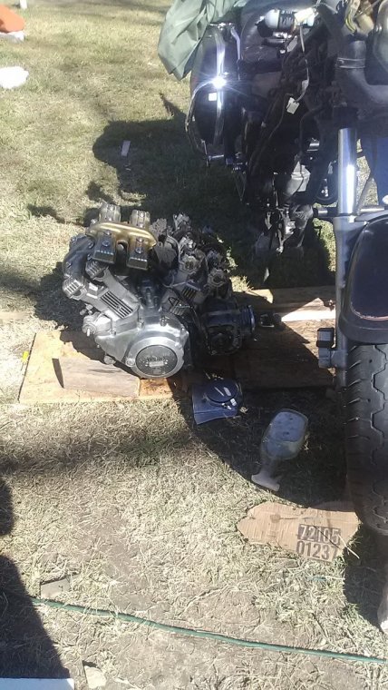

	Hey these guys know all about this bike. Believe me. I'm working on mine. Got my Motor pulled and head off . Blown head gasket for sure . Still cleaning everything up. So they can tell me what I need to do it. OR replace the motor. I'm from Dallas. Moved Joplin Missouri 3yrs ago. Love it no traffic no traffic. Check out a bar called SCOOTER'S in Garland or The Brick in Wylie tell them Pops and Nana sent you.

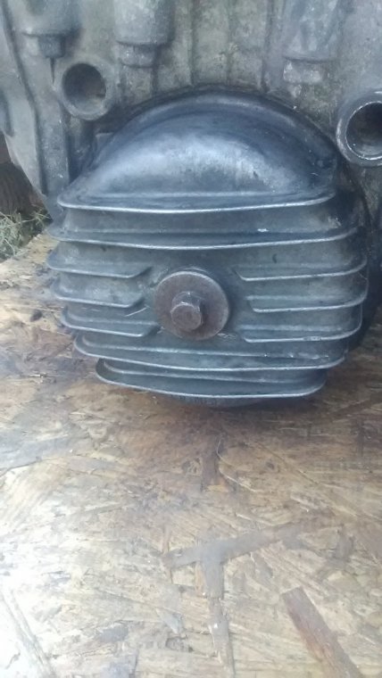

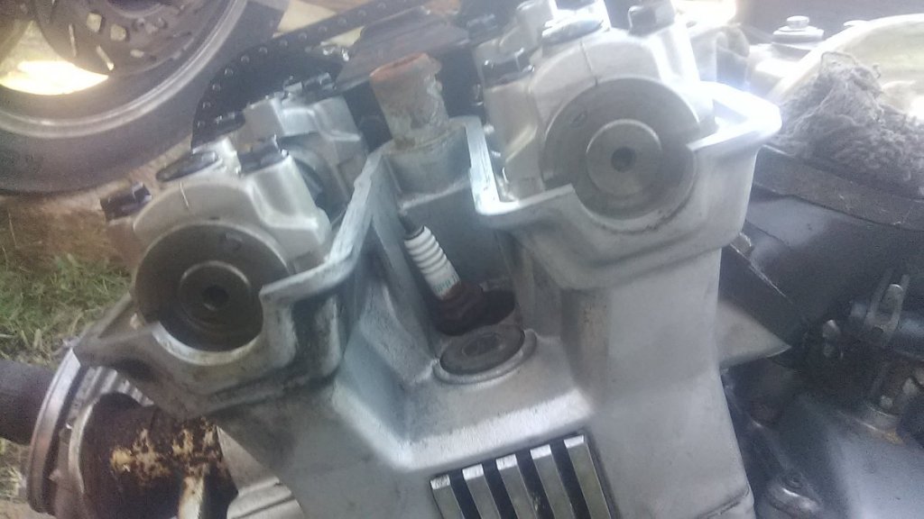

	  Puff of white smoke and milkshake in my oil.Popsnana19655 replied to Popsnana19655's topic in Watering Hole These are the pics where I've got so far I had one of my twin nephews helping me he's 2 years old. And this is pictures of one and three or rear valve cover water sitting in the head bolts. And I will break stuff first thing I broke is the grabber for that little water port thing by the spark plug. It barely touched it in a plastic just broke it turned pretty easy but when I went to grab it plastic was gone. so now I'm going to figure out how to get it out without shattering it all to a million pieces and get everywhere. Be right back after these messages.

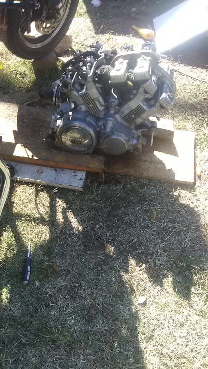

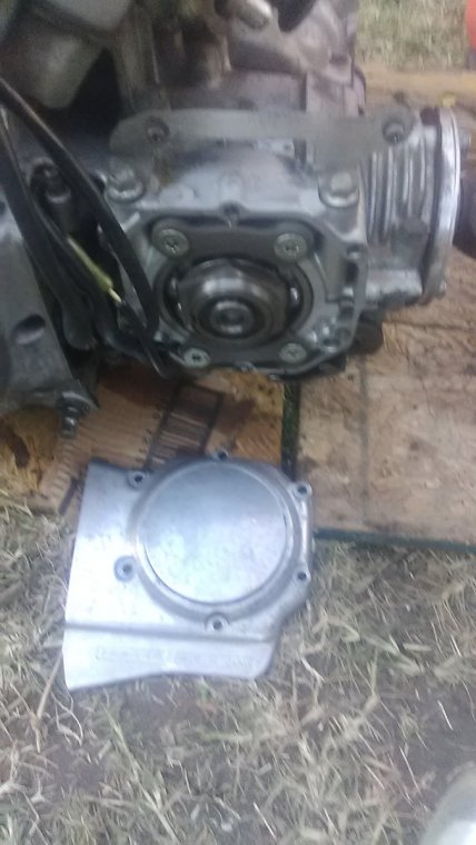

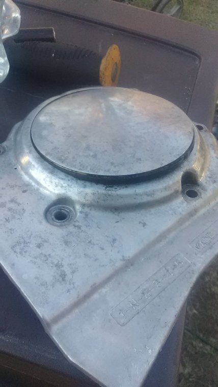

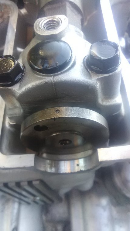

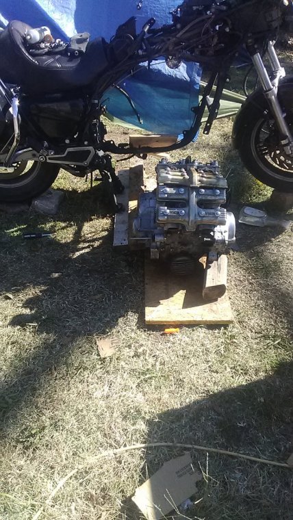

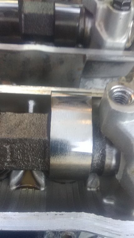

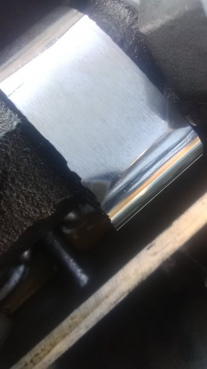

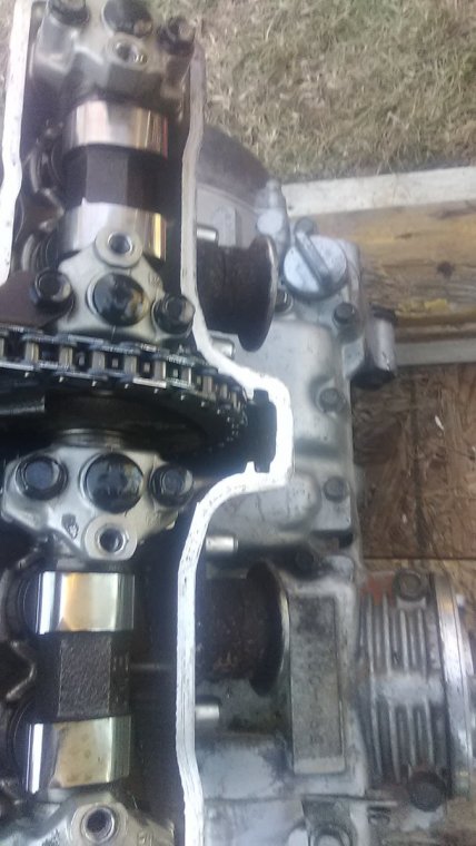

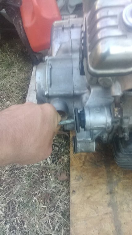

	  Puff of white smoke and milkshake in my oil.Popsnana19655 replied to Popsnana19655's topic in Watering Hole Okay guys weather fine cleaned up long enough to pull the engine I just got the engine out. And I removed the valve cover and that's as far as I got .I'm been cleaning the motor. Yeah I had it on the jack and actually put bolts backwards in the top motor mount area so I could have something to hold on to and ended up pick it up by hand and twisting it out the front side had a little nub it was hanging on. Put bolts in the top motor mount have hand holes it really helps. Also noted with the valve cover off one of the chain guide is missing. And and I got lucky and hit top Dead center the first try. And and is this cover supposed to look like this. Thank you guys and I will keep you posted have a problem holding a damn phone and taking pictures oh one last thing I don't know if it'll show up. The wear on the cams is that normal wear or that little triangle at the top it's like that on all of them I got close up flashes not letting you get a good picture. Just a note from riding air Cooled the fins like this on the they're on the bottom of the motor I have to clean them everything else they're to help cool the bike and if they're full of crud dirt and stuff it won't help but on the bottom back side of the motor a half inch thick so they down on the ground and clean them out it will help cool your bike down a little bit I hope or it should. Easy to take a picture of these things then rolling the motor up and trying to hold and take a pic.

	  Puff of white smoke and milkshake in my oil.Popsnana19655 replied to Popsnana19655's topic in Watering Hole Good then. I'm about ready to pull it. Just got the drive shaft left to do. Do I need to pull the rear wheel. Or disconnect at the york there. Stopped there got attached by my twin 2yo nephews . They're helping with taking parts and tools then running. LOL looking up drive shaft now.
