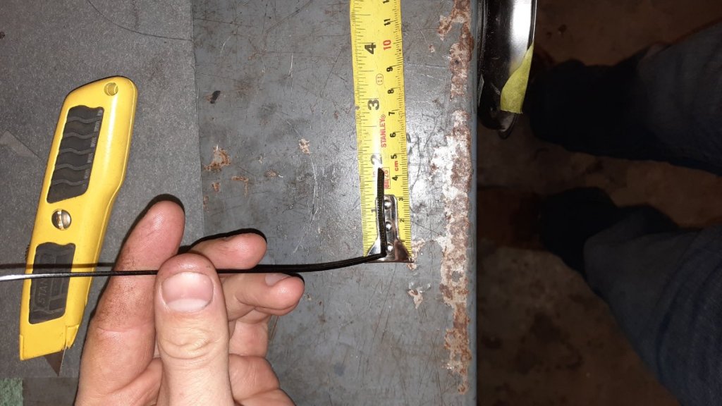

I have seen this trick mentioned briefly when doing some researched but the replies were mostly along the lines of it being sketchy or difficult. In fact it works very well and I have used this trick on both my FJ600 and now my RSTD. Use a good thick ziptie and there is no risk of it getting cut by the valve. The method I use is this: 1) Bend a heavy(thick) zip tie to 90 degrees by pinching it with pliers, make sure that the short leg is 1-3/4" long to reach the valve. 2) Turn the engine over until the cams are pushing down the valves and insert the zip tie with the stem facing between the pair of valves you want to check. 3) turn the zip tie gently to one side until you feel light contact or about 20 degrees, then while holding it there, slowly turn over the engine until you feel the valve grab the zip tie. If you miss, try lowering the valve and try again. 4) If you caught it, properly, you can keep turning until you have enough room to pry out the shim from the bucket and grab it with a magnet as usual. 5) when do e, just turn the engine slowly backwards until it let's the zip tie go. Then you can wash, rinse and repeat for the remaining valves. Hope this helps the other cheap buggers like me who don't have the tool handy!

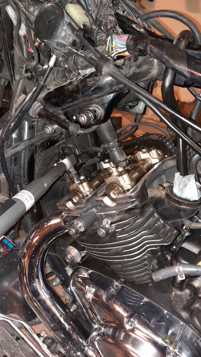

Little update, Turns out that the head bolts can be tightened with the cams in place. Figured this out AFTER pulling the rear cams🙄... Anyhow, pull the rubber plugs on top of the cam caps and then turn the engine slowly until the through holes in the cam shafts line up with the holes in the caps. At this point, you can pass a long 8mm Allen key bit through the hole and start torquing. You'll only be able to do the front or rear cam at a time, so to tighten evenly you should have to turn the engine over a few times by hand. I would say most of the bolts took about 1/4 turn before clicking over but at least 4 took over a half turn after unsticking a bit, I was worried they may be stripped but they did click eventually! Double checked all the bolts again and they all clicked at the proper torque now. Had some fun resetting the timing with all the valve springs fighting me(don't pull cams if you can help it!) But one I figured out the trick it wasn't too bad. Now the next step is to adjust pretty much ALL of my valve shims, I think previous owner set the tighter I stead of looser thinking it would be better. One shim was upside down so I am not thinking it was factory. Below are the measurements found.

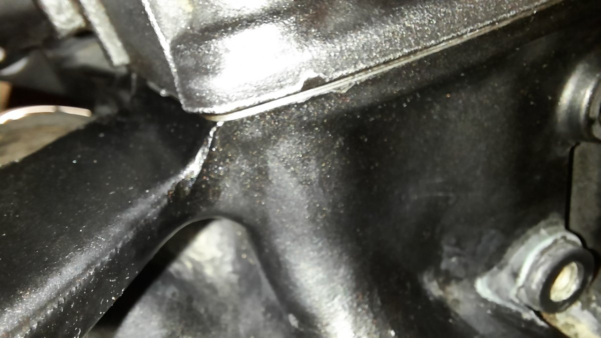

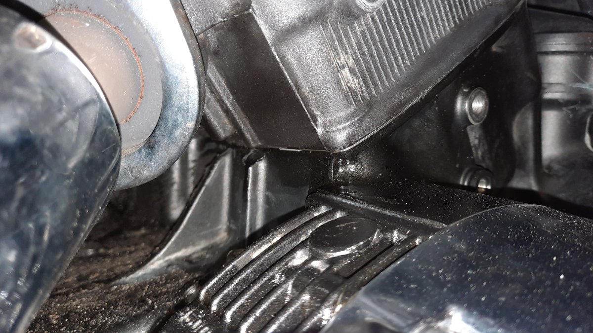

Okay, so I pulled the covers, cleaned everything up and then went for a test ride, about 8km. Pulled the covers and found oil weeping from the head gaskets at the front left cylinder corner and rear right cylinder, also at the corner. I can't really tell if it is leaking further inside the block on the other corners but it does not seem to be so far. So, I'm thinking(praying) that it is just improperly torqued head bolts as there is no evidence of coolant leaking so far. Going to pull the covers, then cams and torque the bolts once the bike is parked for the season. Might as well check the valve clearances while I am at it as well. Now, if it does turn out to that the head gaskets are shot, is it possible to pull both heads off with the engine still in the frame or do I have to pull the whole engine out? I know it would be tight but a quick glance looks like it may be possible. Aric
