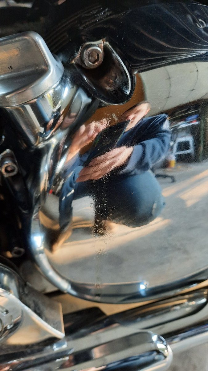

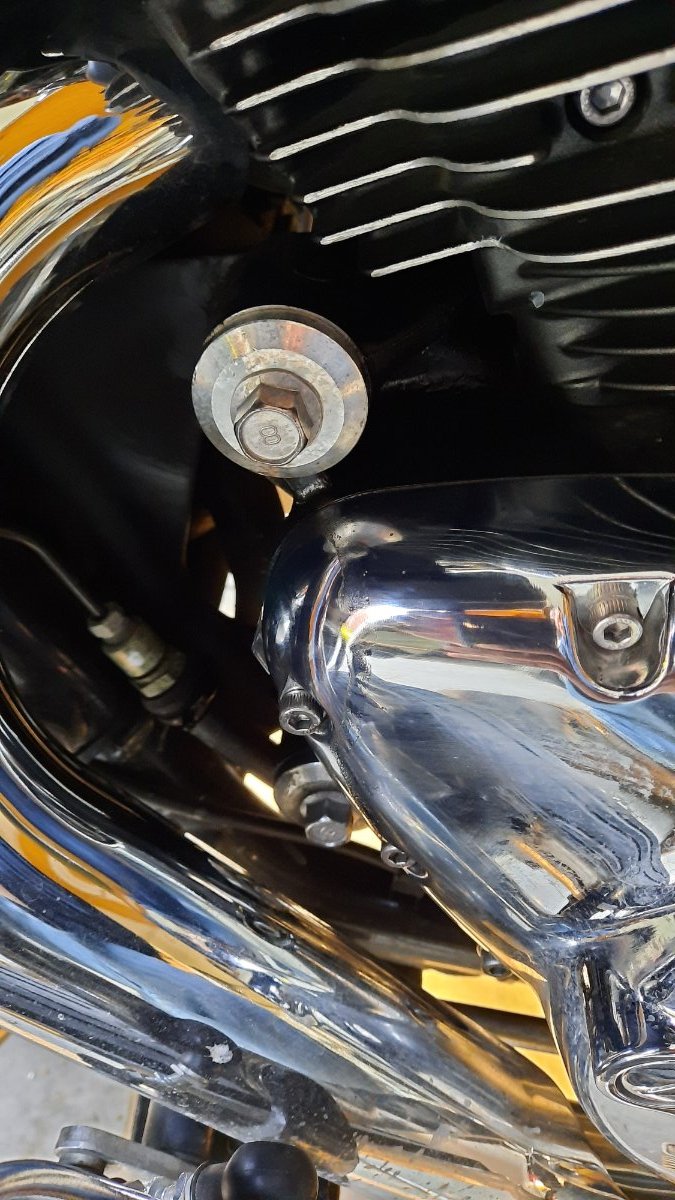

I can verify that it is definitely not fuel or coolant. I'm planning to pull the covers again, give it a good clean to get the dirt and oil residue off and then run it up and down the road to see if I can spot the source. There is too much oil and dirt that has crept up the surface of the engine to see clearly. I'll have to pick up some engine cleaner and tackle it after hunting season next week.
Well, I was going to sell my bike but two things stopped me: 1) My wife just shook her head and say keep it because I like it so much and, 2) I started to notice an oil leak under the bike about a month after I bought it. Can't sell it like that! So, she is here to stay and I'll ride the heck out of her but I want to fix this leak before it gets worse or is hinting at another issue. Bike has 54000 miles on it. I removed the side covers(fake fins) on both sides of the engine and tried to track down the source of the leaks. From first glance, it seems to be leaking around the head gasket on the front left and rear right cylinders, very slightly. Does not seem to be running down from the valve cover that I can tell but I have not dug in to the bike any further to look. I have heard about a TSB regarding improperly torqued head bolts on the royal stars of this vintage but not sure if that included the RSTD model. I'm hopeful that I can get away with just re-torqueing the bolts after getting the cover off and I suspect having to lift out the cam shafts. Is this feasible or am I looking at a full head rebuild as well? I have not noticed burning coolant at all but the reservoir was low. I never checked it when I bought it as it slipped my mind so I have no base line yet. I did not see any oil in it either but have not checked in the radiator. No coolant present in the oil either at this point. Suggestions? Guessing I'll have a project for the winter😋

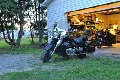

I'm going to try linking from my image host site, Imgur and see if that works. My daughter told we we had to call her Marshmallow, seeing as how my other bike is named Fudge (model is a '90 FJ600). So I present Miss Marshmallow in all her glory. Got her and a parts bike together Both were non running but since fixed and in various pieces. After some new fluid, tires and seals, brake rebuilds and scavenging a few parts, Ms. Marshmallow is now fully dressed and ready for a safety. She just needs a few new rubber grommets for mibor cosmetic fixes and to touch up the soldering on the CLASS system. I appreciate all the help so far getting her going!
