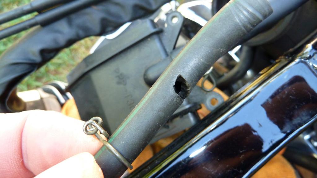

	.thumb.jpg.5bc608c29d230c44c77c79acb0510cd8.jpg)  Need Advice - 2004 Venture 11k miles runs great BUT...Condor replied to Joelgonia's topic in General Tech Talk On the backfiring on deceleration all the suggestions are right on, but I found another. Sabotage. While working on my '99 which had been dealer serviced by the previous owner I ran across the attached when I had my tank off. I know chafe when I see it, and this wasn't. It was hidden on the back side of the hose where it couldn't be seen and was definitely cut. The bike backfired a little with the OEM exhaust, but like crazy after installing the Bub's. I thought it was the Bub's. Looks like that wasn't my problem, but some devious mechanic that wanted to create additional work. Easy fix with some 100 mile an hour tape.
