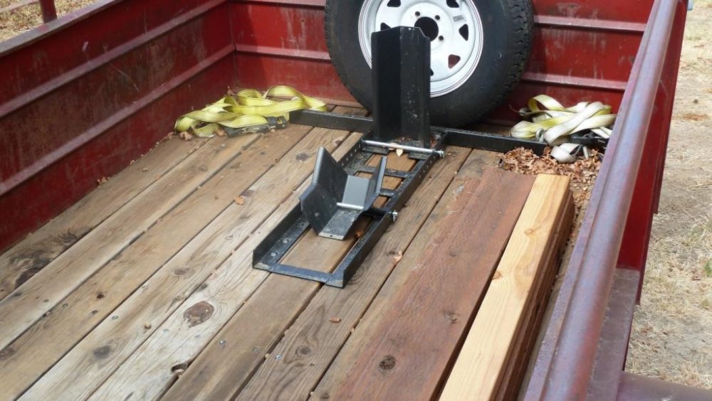

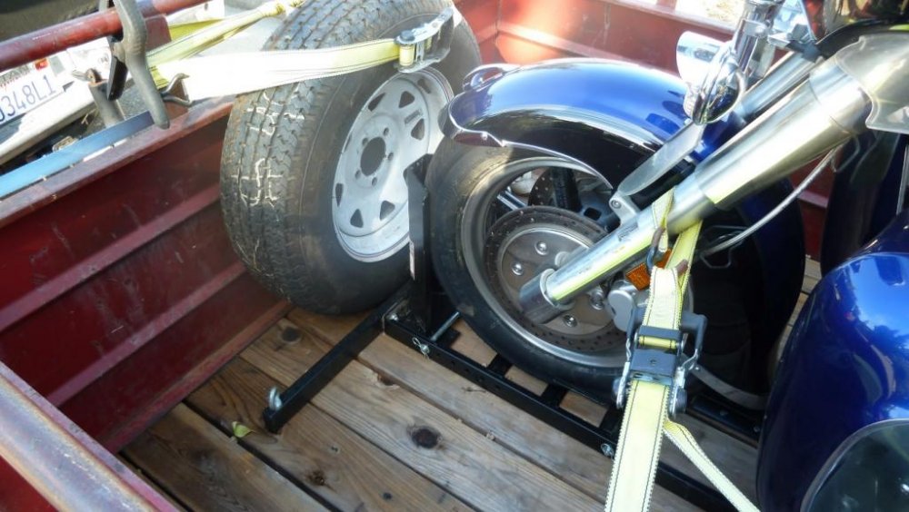

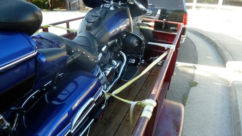

	The stinger is interesting. The only thing I don't like about it is the bike is more or less unprotected and the mercy of anything the rear tires of the tow vehicle can kick up. And the price is huge factor for what it is. The fact that is does stow away easily is a plus and does justify owning it and only using it a couple of times a year. However, IMHO, price wise you might be a lot better off with a duel purpose landscape trailer. A 5x10 with side walls, top rail, and ramp gate.... Unless you live in a condo?? It's cheaper and great for making dump runs or hauling firewood. I bought mine for $750, and after a lot of trial and error, and installed a Harbor Freight condor copy chock. I think the 5x10 landscape is the epitome of a Venture hauler. Here's a few pics which I think I've posted before on a different thread, but it give you an idea.
