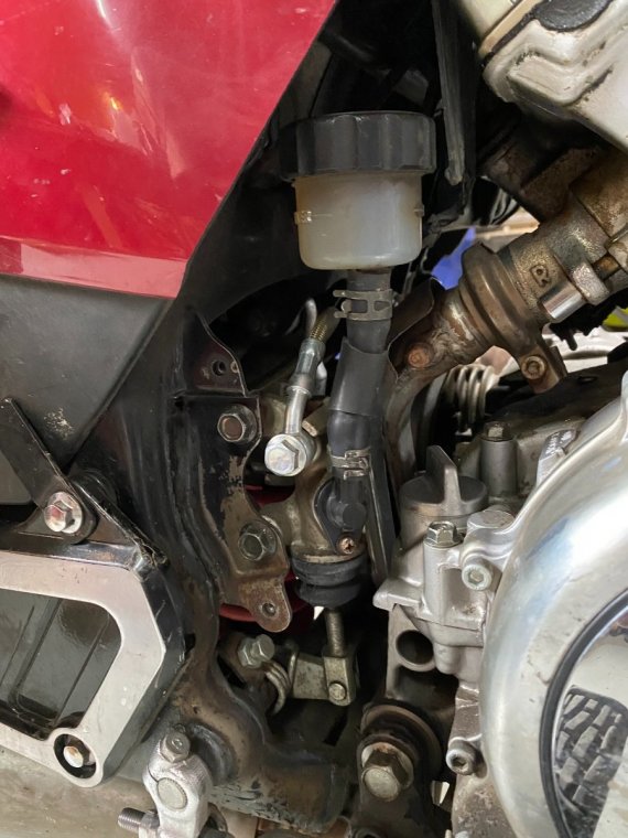

Good Lord… I think I remember what I did with this upgrade now. Rebuilt a MC from a Gen I MK II venture as the piston is 11/16. I took off the splitter that went to the front brake and plugged it off. Took the old reservoir off and replaced with one off a royal star venture. It was a while ago and my brain finally woke up… Hope this helps and that I didn’t misrepresent the project. -
Rear brake caliber dragging
MoonShine replied to SpencerPJ's topic in Venture and Venture Royale Tech Talk ('83 - '93)

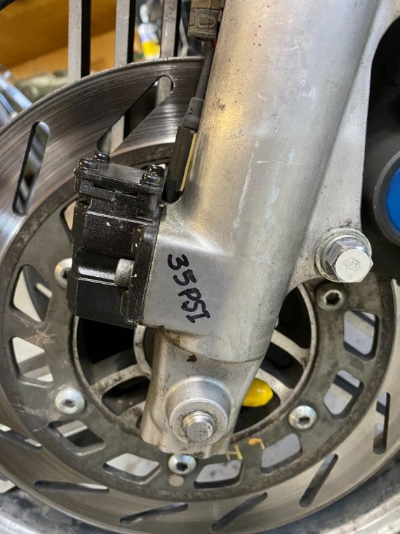

Ok. I have been going through my records and cannot find the make model of what bike this part came off of…. I’ve attached a few pictures after unbolting that might help. There are 2 bolts mounting the MC and 1 for the reservoir. There is also another outlet that I capped off as my front and rear brakes are separated now. By bolting up fairly easily, I mean that the brackets on the frame lined up pretty well with the new set up. I may have had to drill a hole? I believe I only had to adjust the slack after bolting in. Apologies for any confusion. I will keep researching to find the bike model and year for you. -
Great job on the repair and all the info! I did the same repair with the help of the good folks on this forum. I later switched to a 2000’s Royal Star Venture MC and reservoir for convenience. It pretty much bolted right in without too much trouble… -

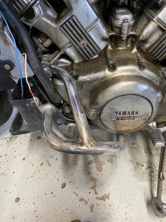

Center stand mod. I cut around 2 inches off the bottom of the center stand and welded some cross tube on the feet to make a “ride off” stand. It is very easy to pop on the stand (even in flip- flops) and rear wheel is on the ground when on the stand. I carry 2 small chunks of 2x4 to tip the center stand on to lift the rear wheel off the ground or stabilize on soft ground.
Center Stand
MoonShine replied to SC89Venture's topic in Venture and Venture Royale Tech Talk ('83 - '93)
I cut around 2 inches off the bottom of the center stand and welded some cross tube on the feet to make a “ride off” stand. It is very easy to pop on the stand (even in flip- flops) and rear wheel is on the ground when on the stand. I carry 2 small chunks of 2x4 to tip the center stand on to lift the rear wheel off the ground or stabilize on soft ground. -
