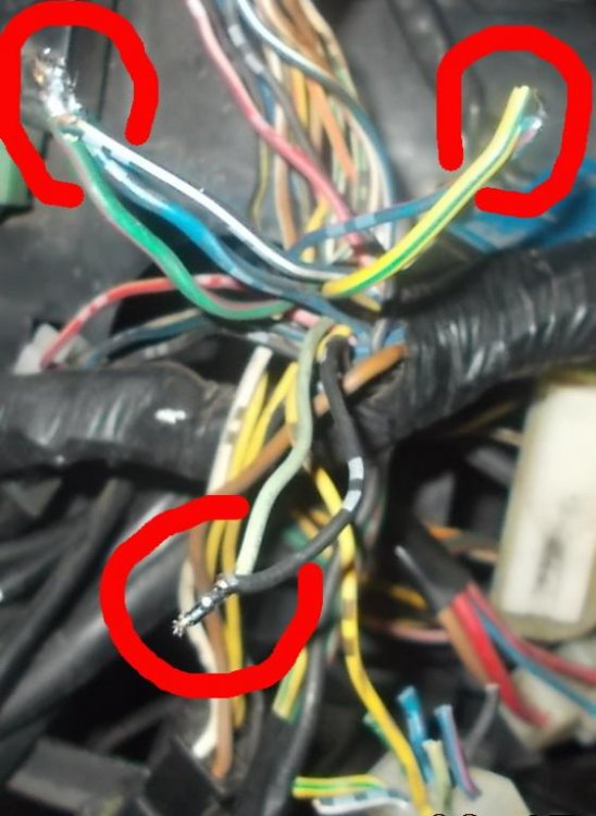

The title says (RSU) that was a typo I should have put (RLU) Other posts covered this but a picture says 1000 words. To bypass the RLU on the my 1988 Venture Royale I unplugged the wires and soldered them together as shown in the picture. This will give you a functioning low/high beam and will also push power to the High Beam indicator when you have High beams on. The extra wire left on the plug would goto the Headlight Out indicator on the dash and is no longer needed. As the best indicator of a burn out headlight it lack of illumination on the road. Tie Together the Green/White + Blue/Black + Blue/White Tie Together Yellow/Green + Blue/Red Tie Together Black + LightGreen This will allow the High Beam light to work and let the light dimmer on the handle bar change from between Hi and Low Beam The Yellow wire if for the White Head Lamp Out Indicator and is no longer useful.
