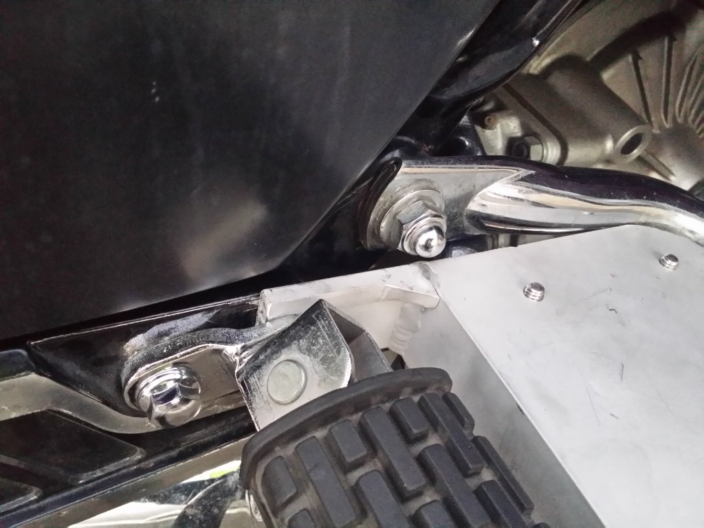

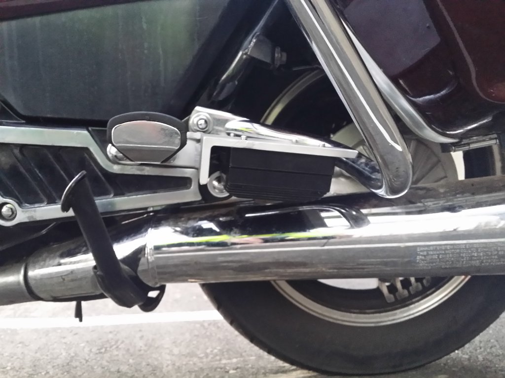

Finally got the CE605 installed last weekend an been riding it to work finally the last two days. The CE605 has made a BIG difference in voltage readings. I have NO trouble getting the expected 14.4 volts at almost any rpm but idle. Even then its almost 13 volts and comes up quick to 14 volts @ 800 rpm. So, the wanna-be r/r from amazon that is NOT a true Shindengen just doesn't cut it. I'm very happy with these readings and are what I expected in the first place. I had a hell of a time figuring out where to mount this thing. Finally designed a bracket to take advantage of the extra rear footpeg bolt hole. Here's a few shots of the prototype bracket. I'll get it powder coated black soon after I make a version two that will hide the bolts. -
