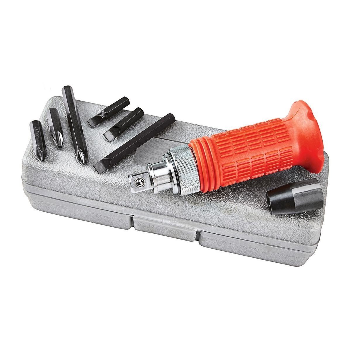

saddlebum Posted November 25, 2023 Share #2 Posted November 25, 2023 Check out the JIS line screwdrivers made by Vessel on Amazon. The grey handled impacta model is actually an impact screwdriver. Great for those tuff screws. Well worth the investment. Link to comment Share on other sites More sharing options...
djh3 Posted November 30, 2023 Share #3 Posted November 30, 2023 One of those "impact" screwdrivers are nice for taking out various tight screws, bolts. Needed to take of some various side covers. thats when I learned about Japanese fasteners being JUST a bit different from other metric fasteners. Back then we had to order replacement stuff from JC Jip Me. I put in allen head screws. 1 Link to comment Share on other sites More sharing options...
skydoc_17 Posted December 4, 2023 Share #4 Posted December 4, 2023 Hey Dan, It's NOT you, it's those pesky Metric fasteners! Harbor Freight actually has a decent Impact Driver for under $20. I like others try to replace every screw with Metric Cap Screws in Stainless Steel. This solves the rust issue and you can use Allen Head Wrenches on the Cap Screws to deliver higher torque to the fastener. Hope this helps, Earl. Link to comment Share on other sites More sharing options...
