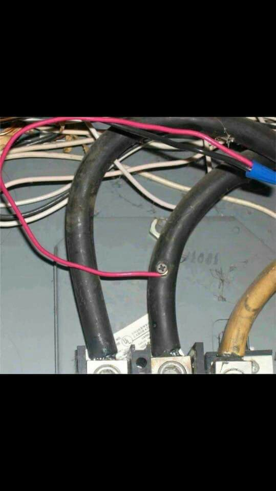

Vickersguy Posted August 25, 2023 Author Posted August 25, 2023 Ahh... it was #4 carb and I noticed when the bike started pulling towards the right... As this is a TECH forum, I thought I might share a special electrical trick I discovered... If you have no room left in your breaker panel in your garage or if you are sad because your air compressor or welder keeps tripping the breaker, here's how to fix it at almost no cost what so ever !!!! TA DA !!! 2

saddlebum Posted August 25, 2023 Posted August 25, 2023 18 hours ago, Vickersguy said: Ahh... it was #4 carb and I noticed when the bike started pulling towards the right... As this is a TECH forum, I thought I might share a special electrical trick I discovered... If you have no room left in your breaker panel in your garage or if you are sad because your air compressor or welder keeps tripping the breaker, here's how to fix it at almost no cost what so ever !!!! TA DA !!! Ironically I rewired a house that actually makes that look safe in comparison. The owner used every thing from several strands of bell wire twisted together to 000 gauge welding cable. On top of that he joined them together in sardine cans which he used as junction boxes. How he never burned the house down is beyond me.

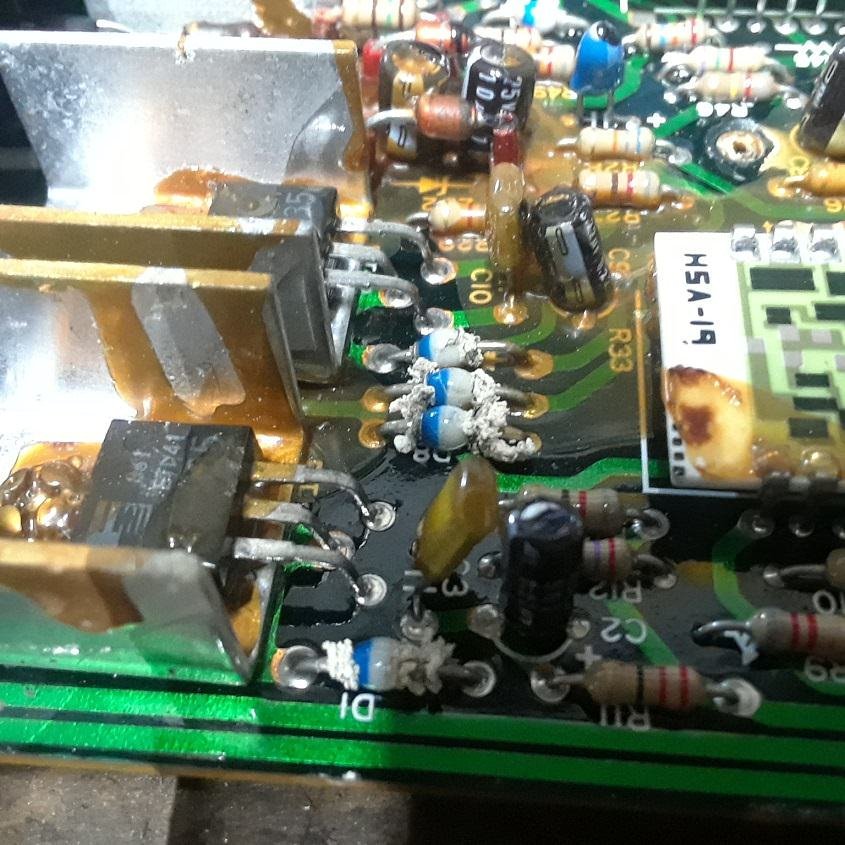

Vickersguy Posted September 14, 2023 Author Posted September 14, 2023 So the bike runs like garbage. Marcal feels it's the carbs and I agree with him. The spark still sucks, however. In Post #28 back up the page I posted a picture of some bad blue/white diodes that were badly degraded next to my beautiful as-new looking diodes. I read in a virago post on another board that even the good looking ones can be bad. I picked the easiest diode to pull for a check and wadya know ! I had hoped they were good because they looked good. I'm going to change them all.

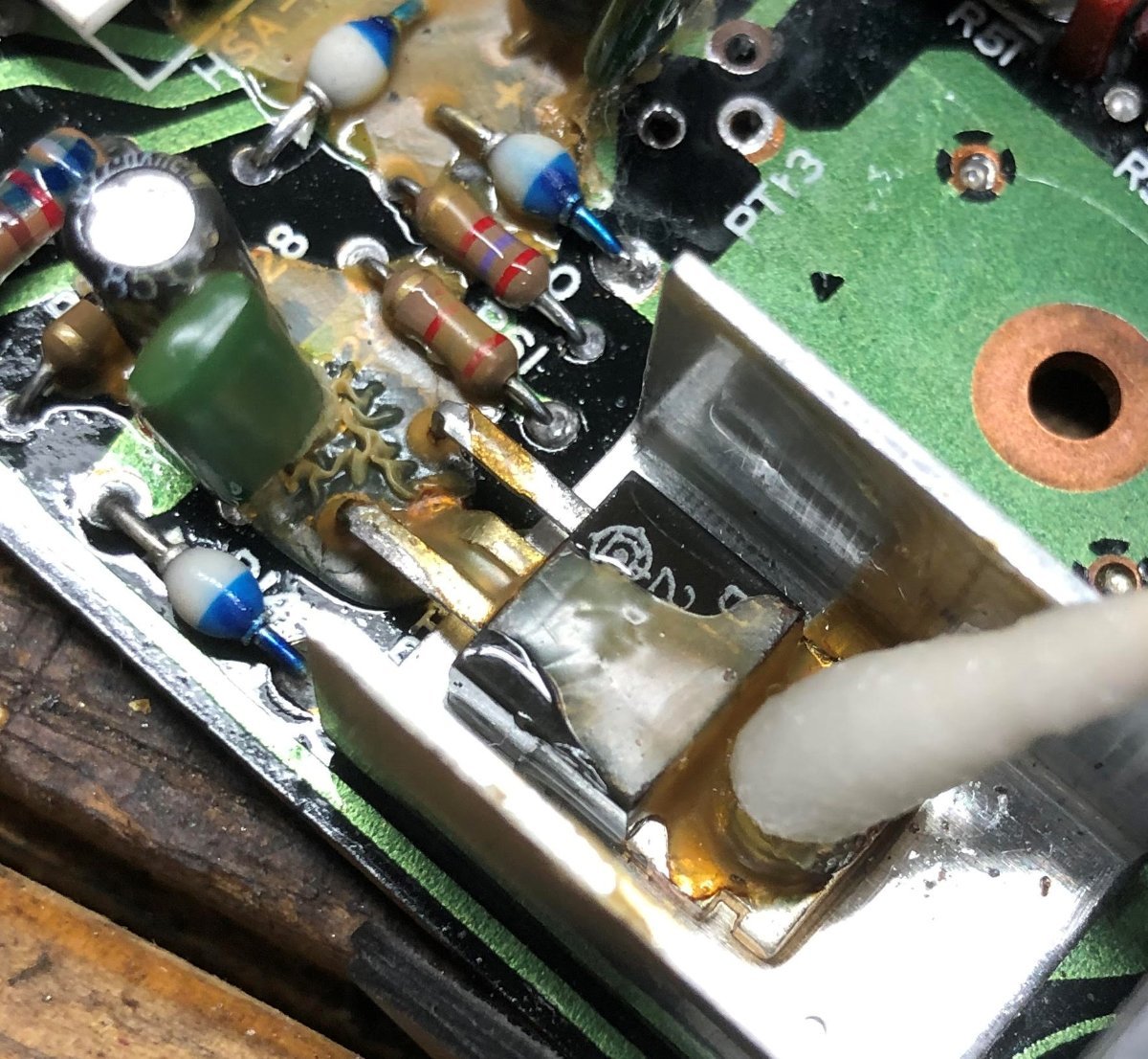

Vickersguy Posted September 15, 2023 Author Posted September 15, 2023 Also, re-soldering the board will be done thoroughly. To quote the Virago guys... Galvanic Corrosion The space between unsealed connectors contains oil, moisture, fingerprints, dirt, ...etc. Also, being open to the world's contaminates, these things can seep and leach into the micro voids between the connector surfaces. Enter "Galvanic corrosion", where ionic interchange between disimilar metals acts like a corrosive battery, producing compounds that can interfere with good current flow, even making it act like a semiconductor diode. A good place for dielectric grease. Inter metallic corrosion Many brass and copper connectors are tin plated, and the fine border between those two dissimilar metals is closed to the outside elements. However, a strange long-term migration and intermixing of those metals occurs in that thin layer, leading to a form of inter metallic corrosion, which can also interfere with good current flow. Same can occur at the boundary of a substrate and a layer of solder, which can include boundary cracking of the solder. These types of degradation take many years to form, not an issue within normal life expectancy of typical vehicles. But, becomes real after 30 years or more. We studied this back in the 80's, as part of determining the MTBF (Mean Time Before Failure) of various electronics products. These pictures represent similar biopsy-like micro cross-sections of tin plated copper-clad printed circuit boards. What all this means, is that with the age of our bikes, electrical problems can occur which defy normal diagnostic expectations. For example, you could have a failed wire connector which still shows appropriate voltage, but won't deliver current to a device, like a light bulb. This was my experience three years ago with a failed turn signal bulb. The contact at the bulb base showed voltage, but the bulb wouldn't light up. Maddening. Traced it to inter metallic corrosion within the contact face. Cleaned up the face and re-tinned it, works fine... 1
Vickersguy Posted September 26, 2023 Author Posted September 26, 2023 Changed out the diodes, good news is I didn't kill the box. Bad news, it's no better...

Vickersguy Posted September 27, 2023 Author Posted September 27, 2023 Original type, tin coated solid copper stranded, 19 strands. OEM style. Resistor caps and plugs. I've done everything practical that can be done. I have 9 coils here and I find the probability they are ALL bad, vanishingly small. Ohmed out the entire ignition electrical system to be sure i have full voltage to the coils and the box. Checked all the safety switches and so forth. Re-soldered ALL the connections in the box to cover for cold solder joints. Cleaned all the connectors. etc.etc. My understanding is that the big 4 transistors switch off the ground path for the low voltage side of the coils. This causes the spark when the low voltage field collapses. If, in fact, there is some other pathway to ground, of relatively high resistance, there might be only a partial collapse of the field, resulting in a reduced energy spark. That's my theory, anyway. There may be some other diode on the board "leaking" or it's something else entirely. Don't know. I'm thinking an aftermarket TCI may be the only way out. Can't afford one right now. At the rate I'm going, the new tires I put on it will age out before I get this on the road. Me too. I'll be 70 next month. After all the noise I heard over the ignitek box, I'm thinking this one might be the one I get. https://www.cdireplacement.com/cdi-products/yamaha-xvz1200-venture-royal-igniter-tid14-17-26h-10-cdi-replacement/

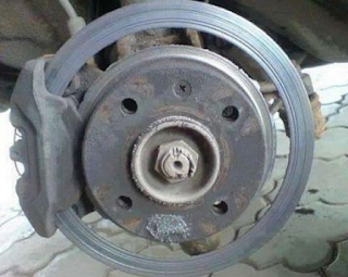

Vickersguy Posted October 19, 2023 Author Posted October 19, 2023 Got the ignition system installed and went for a ride. Much better. I need to dial in the mixture for perfection. Got home and found the right front brake caliper leaked all over the place.... It's always sumpin..
