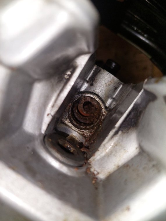

yomaha Posted February 3, 2023 Share #1 Posted February 3, 2023 Good morning fellow venturer's, I'm looking for some help trying to remove joint 1 from the head so i can continue down to the metal gasket and replace all my top end seals. My issue is with the bake light joint for antifreeze that crosses the head under the cam chain. I've been following my books and engine disassembly videos just to make sure I don't screw up and sure enough this joint (called joint 1 in the schematics) is made of bakelite im told and it's just crumbling. The tabs broke off to pull it out and at this point I'm thinking just get it out but I don't want to cause any damage. Any insight would be much appreciated as at this point I'm out of ideas. at this point I've already tried - gentle wiggle - light mallet taps from inside lip -Heat gun -pentrating oil and time Right now im thinking of putting a set of needle nose pliers to it and braking it loose, if I can twist it maybe it'll start to wiggle out. I understand its only held in by the lock pin and a set of o rings so I dont know why it's being this difficult. Link to comment Share on other sites More sharing options...

yomaha Posted February 3, 2023 Author Share #3 Posted February 3, 2023 27 minutes ago, Freebird said: We got a member who can help on this? I've never done it and don't want to tell him something incorrect. @skydoc_17 @cowpuc My patience ran out so I resorted to brute force ( no damage to the case ) just had to break it apart, thank you anyways. Damn plastic bakelite joint. Was ceized all the way around across 2 inches of rust. Never a dull project when something goes spicy on these jigsaw bikes but reliable once they're running. Deff a love hate thing 1 Link to comment Share on other sites More sharing options...
skydoc_17 Posted February 4, 2023 Share #4 Posted February 4, 2023 Hey Don, Sorry I was late! Well, surprisingly enough I'm sorry I was late to the party on this one! Having had to remove a few of these over the years, you did the right thing. The pic indicates that NON- Distilled water was mixed with the Anti-Freeze. The Phenolic material that this pipe is made from is a Strand Reinforced Plastic. Unfortunately, minerals like Calcium and IRON attach themselves to the Strands at a molecular level, and cause the Phenolic material to expand. This is why you are seeing "Rust" in an Aluminum Block with a "Plastic Tube" inserted into it. If this is an MKI Bike, you are going to want to have a good close look at the Water Pump as well. My guess is you will put this back together with a new gasket, it will overheat, and you will think it is the head gasket again, when in fact it will be a bad water pump. Of course, this is just my Opinion. These engines are known for being dependable, so "Something" took that head gasket out. Here again, "Just My Opinion. It would be worth a water pump gasket to check the Impeller of that pump. Just an FYI, the mixture ratio for the coolant is 60% Anti-Freeze to 40% Distilled Water. The other issue I have seen that will take out a head gasket is if the CDI from another Venture has been installed in this bike. (A 1983 or a 1991 to 1993 CDI will not function properly on a 1984 to 1990 bike) Just thinking out loud here. Let us know what you find out Drew, you have peaked my interest. Oh, and don't be afraid to call "Bull S***" on me if you replace the gasket and it turns out fine! I am here to learn, just like you are, my friend! By the way, WELCOME to the Forum Drew, It appears as if it didn't take you long to get to the "Meat and Potatoes" of it all. did it? Earl 1 Link to comment Share on other sites More sharing options...
djh3 Posted February 4, 2023 Share #5 Posted February 4, 2023 Any cooling system or battery needs to be serviced with demineriazed water. For the very reason mentioned. Tap water even filtered has minerals in it and cause issues. 2 Link to comment Share on other sites More sharing options...
