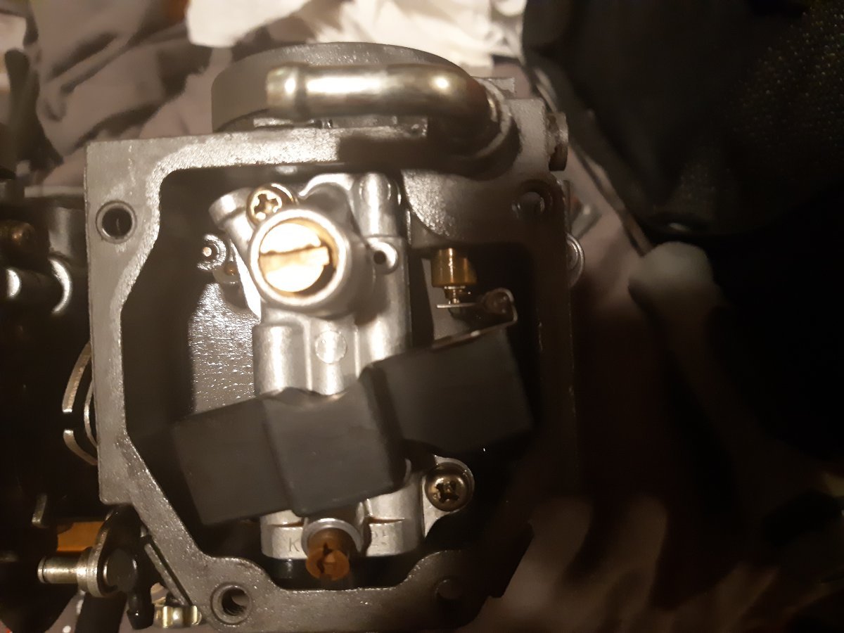

Tysons87venture Posted July 10, 2021 Author Share #26 Posted July 10, 2021 When starting carb upright the valves fall down about 1-2 mm Link to comment Share on other sites More sharing options...
Tysons87venture Posted July 10, 2021 Author Share #27 Posted July 10, 2021 I think that could be my issue then, if I bend the fang this should help hold it up I'm thinking? Link to comment Share on other sites More sharing options...
Tysons87venture Posted July 10, 2021 Author Share #28 Posted July 10, 2021 That might have it thanks alot saddlebum, feels like its sitting tighter in housing now with tab bent more, valve seems to still be working Link to comment Share on other sites More sharing options...
Tysons87venture Posted July 10, 2021 Author Share #29 Posted July 10, 2021 Is this what you were talking about saddlebum? The valve seat that you had leaking causing the flooding? I'm hoping to build up a tester tomorrow to see if I have the correct fuel level now Link to comment Share on other sites More sharing options...
saddlebum Posted July 10, 2021 Share #30 Posted July 10, 2021 (edited) 2 hours ago, BlueSky said: When I checked the float levels in my 89, as I remember, I put slightly larger tubes over the ends of the drain tubes and it was very easy to check the levels. Just checked my bike and suddenly remembered about that. Guess I got so used to setting them up on the bench I totally forgot that method. The tang that touches the needle is what you bend one way or the other until you get the right fuel level. Also the brass seat that the needle goes into should not be moving around. Edited July 10, 2021 by saddlebum Link to comment Share on other sites More sharing options...
saddlebum Posted July 10, 2021 Share #31 Posted July 10, 2021 1 minute ago, Tysons87venture said: Is this what you were talking about saddlebum? The valve seat that you had leaking causing the flooding? I'm hoping to build up a tester tomorrow to see if I have the correct fuel level now In my case I managed to get a burr on the outer brass seat that the needle seat goes into and it caused the needle to stick Link to comment Share on other sites More sharing options...
Tysons87venture Posted July 10, 2021 Author Share #32 Posted July 10, 2021 Just now, saddlebum said: In my case I managed to get a burr on the outer brass seat that the needle seat goes into and it caused the needle to stick Ok the theory is kind of making sense abit more to me now, I can see now that I'd have much less fuel before the valve closes, it was fitting loosely in seat so I'm guessing is was just allowing extra fuel through, now it's just a matter if its enough fuel to keep her running, thanks again for your help! Link to comment Share on other sites More sharing options...
