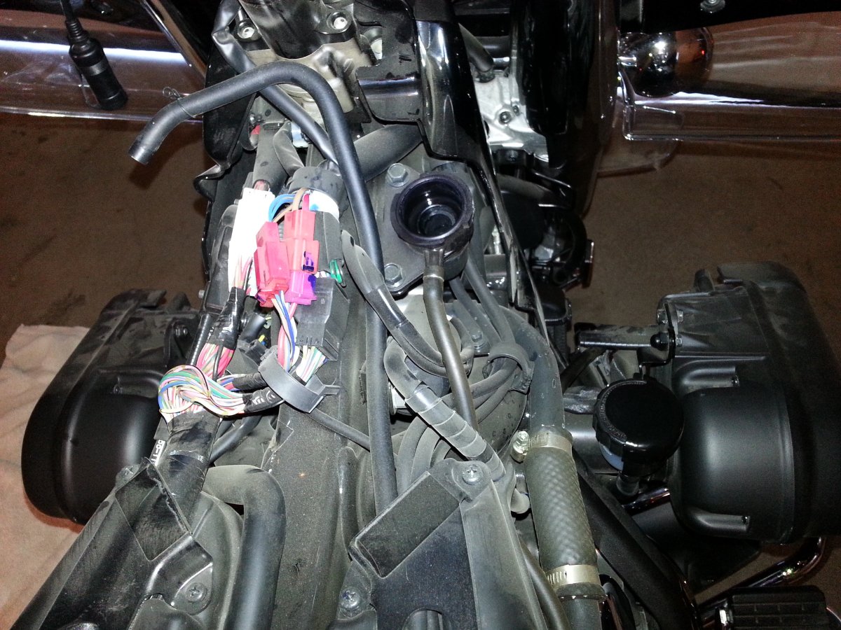

Du-Rron Posted December 3, 2020 Posted December 3, 2020 5 hours ago, VentureFar said: where do I pick up the connectors to test the kickstand switch? Thanks VentureFar... This is an old pic of under the tank before I added tthe relay. Dont see the connector here...at least from this view.
