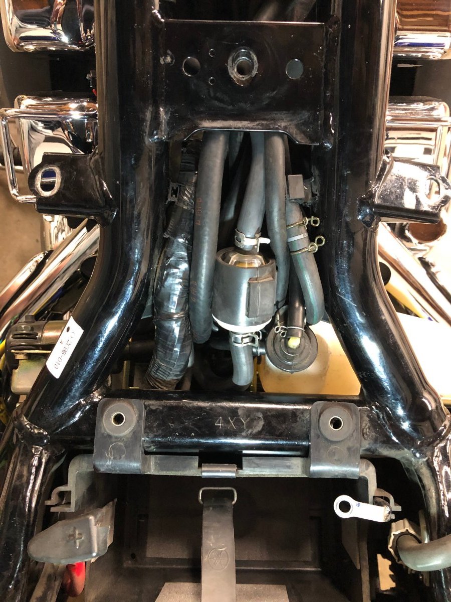

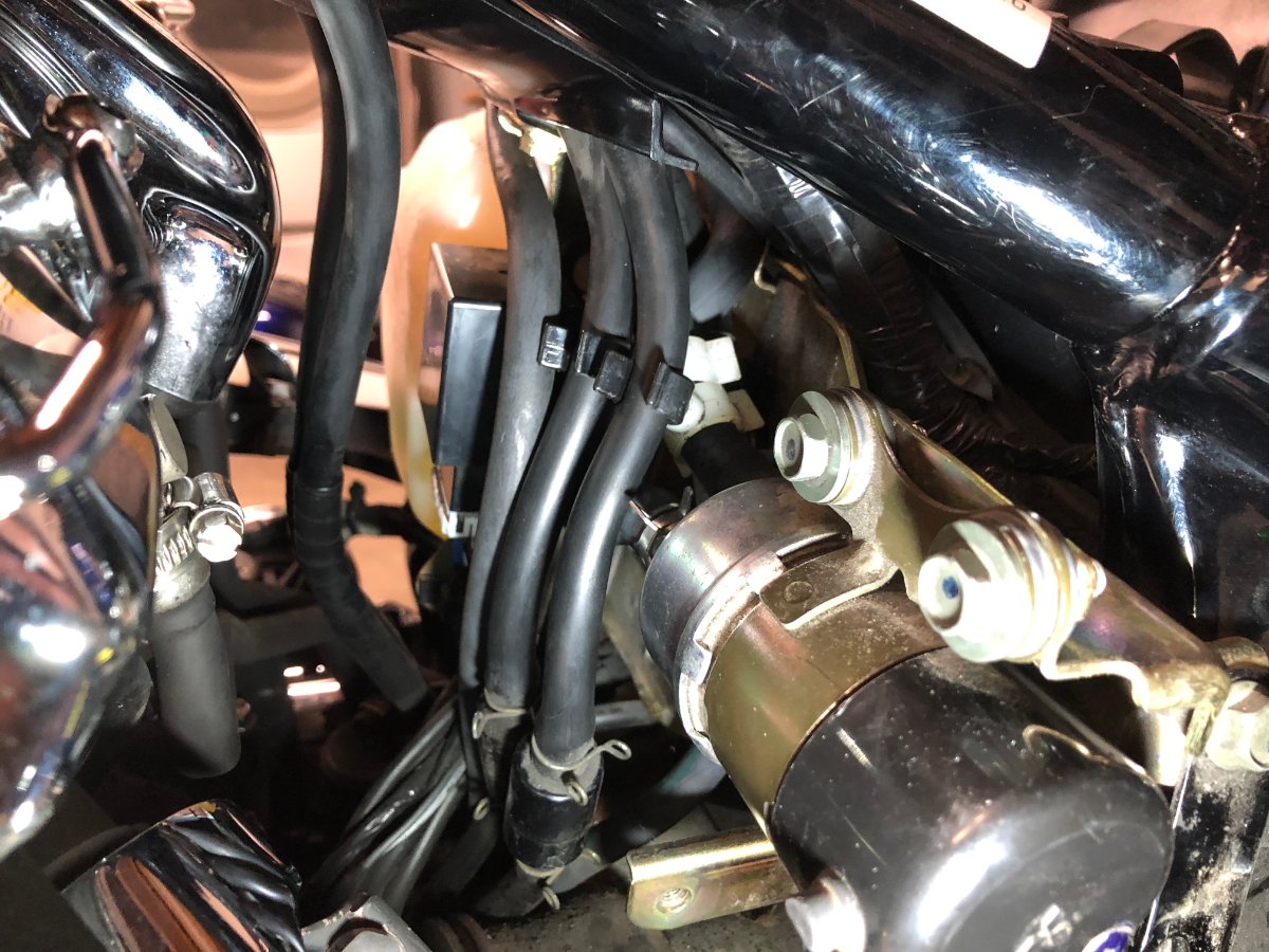

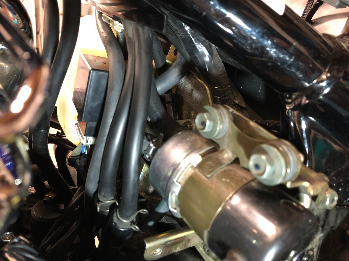

circa1968 Posted November 10, 2020 #7 Posted November 10, 2020 (edited) Thank you for this video and info on the NAPA filter. I spent the better part of an hour repositioning the myriad hoses in that area from the rats nest they were (drove me crazy every time I looked at that) to make them more cleanly routed, freeing up enough space to put the filter in the hose area. See attached photos. A couple of key things to make this work: Remove the u-shaped hard rubber tube on the hose from the filter to the pump, this makes it easier to reroute it. Rotate that little black can, held on by the white p-clamp w/ the PIA screw/cap nut, ~45 degrees towards where the filter used to reside. loosen the hose clamp & rotate the pump hose going to filter ~180 degrees. Its preformed to go down from the pump and you want it to go up and back. I had a good bit of extra hose length going from the tank to the filter and did not want to cut it, so basically had to snake it around a bit under the tank, making sure not to have any kinks. Its not currently secured in position w/ any zip ties but just a tight friction fit and the hoses sorta holding it in position. I may take a second look at ensuring it cannot move and add some zip ties to be safe. Edited November 10, 2020 by circa1968 spelling 1
