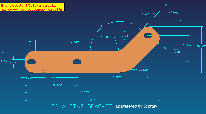

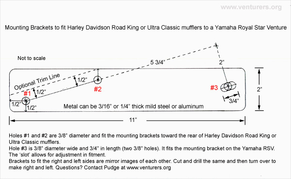

Roadflyer Posted November 2, 2019 Posted November 2, 2019 I just bought a pair of Street Glide mufflers (same thing) for $35. Just need to find the bracket drawings now.
Roadflyer Posted November 3, 2019 Posted November 3, 2019 Here are a couple of versions of a bracket. https://www.venturerider.org/forum/attachment.php?attachmentid=117955 https://www.venturerider.org/forum/attachment.php?attachmentid=117956 Thank you Sir!! I do like the drawing on the right!!
