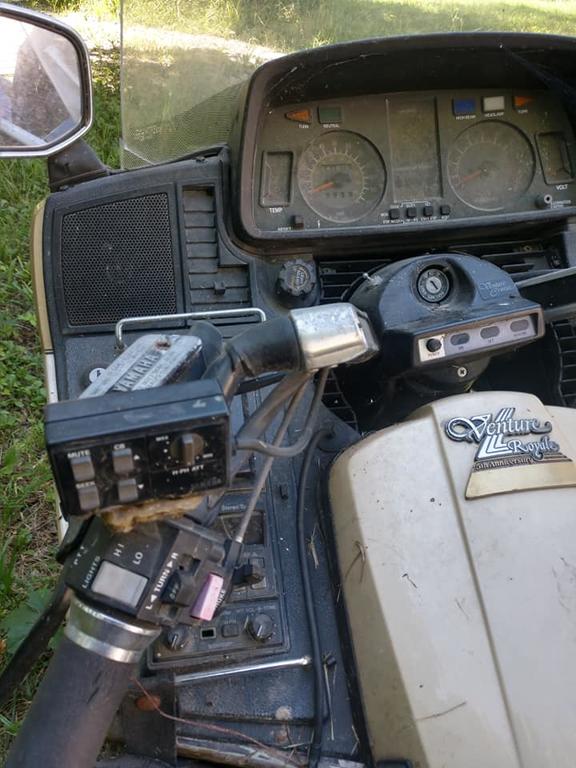

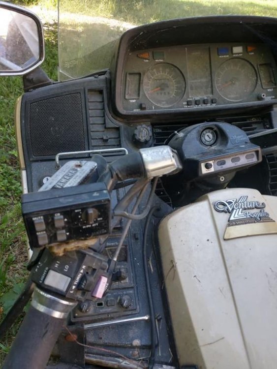

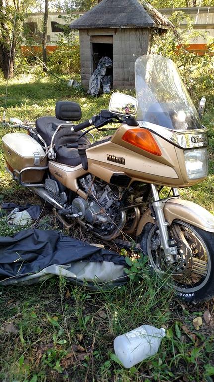

snyper316 Posted August 1, 2019 Posted August 1, 2019 So I picked up a New to me 87 Venture Royal Sunday afternoon for $400 its got the famous E4 Code. Also when I was looking over the carbs I noticed a hose coming off the Number 1 Intake port with a screw in the end of it. Is that where The vacuum actuator for the cruise control feeds from? I bought the bike not hearing it run the guy said it ran darn good before he said it got hot, Which leads to another question. Did the temp gauge work correctly on the 87's? He said it was a 90 degree day when it happened so he replaced the water pump and never finished putting it back together. I got it home and fired it up with some starting fluid then ran some gas from a gas jug later on to move it temporarily. I used my weedeater gas jug and filled the bowls first and found a float or two sticking, It don't seem to be sticking now and I have moved it outside to allow room in the garage to put the 83s up and change the tire on the 83 I just sold. Seems CB traffic is also very quiet these days! Only thing I don't have for the bike is the head sets and found some of those on Ebay. Also once I get the solders fixed on the Air ride does it only set in the accessory position or should I be able to do it with the bike running? I know the compressor works because it came on in Accessory position. I tried to look that up in the manual but it don't state that or maybe I missed it somewhere. Anyways here is some pictures of the bike.
