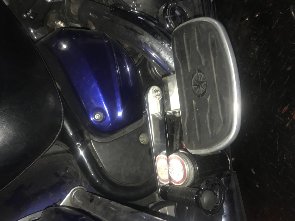

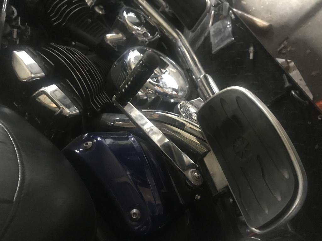

RDawson Posted March 1, 2019 Posted March 1, 2019 I finally got my parts back from powder coat and installed I integrated a Wolo horn mount in the right side mount. I went ahead and punched out a few more sets while I was set up. The question is I plan to donate some to Freebird's MD raffle and for St Jude and I'm not sure if people would want the horn mount or is it better to cut it off before powder coating? I guess I should also ask if anybody wants them at all.
slowrollwv Posted March 1, 2019 Posted March 1, 2019 Ronnie they look great. As for the horn for the horn is a good idea. I use to make a horn bracket out of stainless steel and a lot of people wanted them. I would leave the parts as is and let the people decide if they want the horn bracket.

RDawson Posted March 2, 2019 Author Posted March 2, 2019 Hey, if the stainless is a hassle, I am sure the alum. could be polished up pretty nice. Just thought they looked pretty slick and I am sure my wife would like another option for foot position. Craig I made these after the 9 hr trip back from Don's took a toll on my wife. The arms are 1/4" 6061 aluminum with nylon swivel washers for smooth movement. Tension in adjustable. Pegs can be black or titanium color. All stainless hardware. You do have to drill one 1/4" hole in the floorboard mount bracket, takes longer to do that than install them. I have the same type bolt heads as on the side covers to match them. I go in for surgery Tuesday so it'll be a few weeks before I finish the ones I have cut out and can make more. I think I'll do some with and without the horn tab. If there's much interest I'll list them in the classifieds. For members only they'll run $125.
