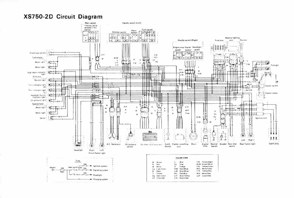

tusticles Posted January 13, 2019 Author #15 Posted January 13, 2019 Next thing is assuming you have the wiring diagram follow that circuit, you can also post the diagram used so we can play along with you. Here's what I've been using off a google search. Unfortunately, I don't have an official one, nor seem to be able to find one for 78' xs750se. You're able to find the one that I'm using if this is poor quality for you by googling "1978 xs750se wiring diagram" and clicking images. It's the second one as the first one is for an 850 I believe.
Patch Posted January 13, 2019 #16 Posted January 13, 2019 Wow at 1st glance this looks like a an underground/map of Jeff's basement plumbing;) I'm going thu it but as mentioned follow the wire back from the headlight through the opened harness.

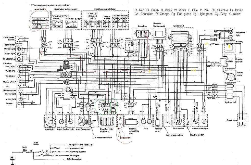

Patch Posted January 14, 2019 #19 Posted January 14, 2019 Like a bone chasing a dog I found this schematic. I am assuming the red wire trace I show is the problem. But also to be done with it I personally would open and clean the ing. switch. Also while you're at it inspect the ground as marked on the bottom center of schematic. labeled black at the frame connection/termination - Yellow trace is fuse box power source?? so an easy box to just swap out. Cheers
tusticles Posted January 14, 2019 Author #20 Posted January 14, 2019 Like a bone chasing a dog I found this schematic. I am assuming the red wire trace I show is the problem. But also to be done with it I personally would open and clean the ing. switch. Also while you're at it inspect the ground as marked on the bottom center of schematic. labeled black at the frame connection/termination - Yellow trace is fuse box power source?? so an easy box to just swap out. Cheers Wow! Thanks Steven. I greatly appreciate you taking the time to look over that and map it out. It's a rainy day today and tomorrow here in San Diego so I'll look in to those Tuesday afternoon or Wednesday and report back what I find with either corrosion or wire quality level.
