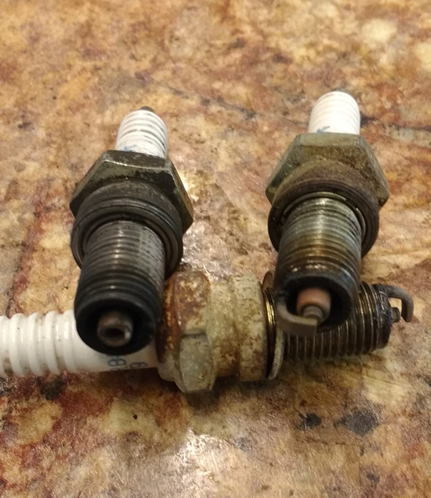

camos Posted September 9, 2018 Posted September 9, 2018 A few days ago the engine on 89 VR started running like crap. Yesterday I found the left front plug cap was loose. The brass insert was elongated which meant there was not a good connection to the plug. Replaced it with one off the 90 VR and it seemed to run a bit better but not much. Today I replaced all the plugs and found the left front plug was not properly tightened and was actually broken. Never seen anything like that before. Hopefully the missing bits will make their way out of the cylinder before they do any serious damage. Not going to hold my breath on this one.
Marcarl Posted September 9, 2018 Posted September 9, 2018 Yep!! looks like they need some renewing. I would grab a stick magnet to see if I could maybe by chance find it in the cylinder. It would make me feel better. Not saying it is even in there anymore, but you just never know.

camos Posted September 10, 2018 Author Posted September 10, 2018 I think you are all right, however, this happened three days ago and I've ridden the bike for about 6 hours since then so I decided not to worry about dark possibilities and just replaced all of the plugs. Just going to cross my fingers and hope that those two little bits will make their way safely out the exhaust. It seems to be running well so far at least. I've owned this 89 VR for about 3 years and this is the first time I have needed to change the plugs. It's my guess that whoever put the plugs in did not get that one plug tight enough. It appears I should have checked them all right after I bought the bike but I didn't think of it and just changed all the fluids. Live and learn.
Patch Posted September 10, 2018 Posted September 10, 2018 This plug allowed for compression leakage as seen on the bottom surface of this spark plug nut. The resulting leakage would of course lower combustion temperatures increasing carbon buildup in that one jug and is evident on the plug threads . The link below brings you to the NGK trouble shooting site with an explanation that fits this scenario. http://www.ngk-sparkplugs.jp/english/techinfo/troubleshooting/10/index.html

camos Posted September 13, 2018 Author Posted September 13, 2018 This plug allowed for compression leakage as seen on the bottom surface of this spark plug nut. The resulting leakage would of course lower combustion temperatures increasing carbon buildup in that one jug and is evident on the plug threads . I think the carbon buildup on the threads would most likely be from leakage around the threads. Even the resistor had a coating of carbon. I mentioned in the original post about the brass insert in the cap being ovaled. My guess is the wear was from the plug flopping from side to side by combustion pressures. Also, as I have previously mentioned in a couple of posts, I thought there was a bit of a valve tick coming from the front left of the engine. Turns out that tick was probably the plug flopping back and forth because the sound is now gone. So far so good, the engine is running very well at this time.
